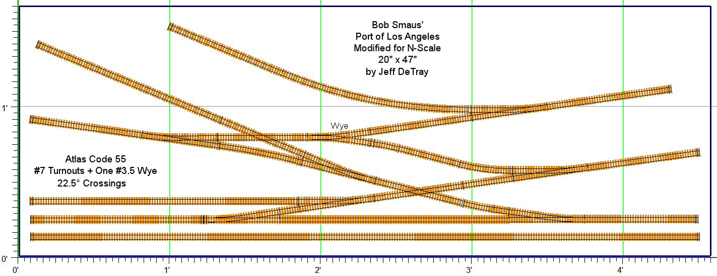

I could not resist drawing up an N-scale version of this track plan, spreading it out a bit, mainly to make the tail tracks longer. All tail tracks are at least 9 inches long. I drew the plan in XTrackCAD, a free track planning program.
The plan could perhaps be made a little smaller by using a different brand of track. However, adjusting for the fact that N-scale is more than half the size of HO and that the tail tracks are longer, the N-scale version of the layout could never be half the size of the HO version. As it is, the spacing between the parallel tracks at the bottom of the track plan might be too close together for manipulating locos and rolling stock by hand.
- Jeff
