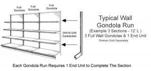

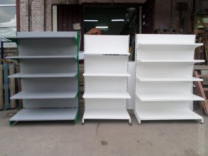

I was just in my local Harbor Freight store this evening and I began to look at their metal shelving. Its pretty damn sturdy, while not being to intrusive with its size of supports. I came home and decided to look up commercial shelving. It turns out the what i saw is general referred to 'gondola shelving'.
1) The support arms are of various lengths (the ones I saw holding up considerable weight o the shelves) were up to 21 inches long, and then 17 inches long. They are of a low profile that would not interfere with a dbl-deck layout.
2) There is a nice thin perforated metal deck as a shelf that might only need a nice foam topping.
3) The upright support beams might well be set in next to the layout rooms stud walls.
4) In my case the studing is on 24; centers, and a lot of this shelving appears to be 48' wide.
...just got me to thinking that this type of shelving could be cut down and modified to provide the sub-roadbed and shelf functions in lieu of our relatively thick plywood subroadbed with bracket supports.
http://www.usedgondolashelving.com/
...and a considerable amount of the shelving might be found on the used market?
http://www.usedgondolashelving.com/Florida_shelving.html

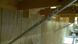

Here's a cheap alternative for supporting benchwork on a wall. I used half inch rigid electrical conduit. Learned this from an old cabinet maker. The back of the benchwork is leveled and screwed into wall studs. Measure the length you need from the front of the benchwork to the wall and add about 2 inches to each end. I flattened the last 2 inches and drilled a couple of holes in each flattened end. With the ends flattened, it is easy to bend the flattened end to just about any angle. One end is screwed into the back side of the front part of the benchwork. I used 1x4's for the benchwork. The other end is screwed into a stud in the wall. it is very easy to level the benchwork from front to back. This is extremely strong. I can put my entire weight on the benchwork and it doesn't budge. I built my bench work in sections, 8 feet being the longest. mot of my layout has been up for around 30 years and I have had no problems at all.
This leaves you plenty of room under the layout for storage and you don't stub your toes on legs at the front of the layout. It also makes access to the under side of the layout very easy.
