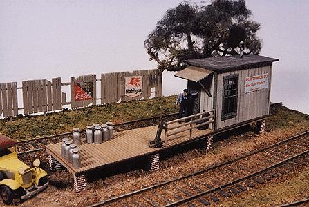

Are you referring to the "Milk Platform"? Because I plan to use this kit

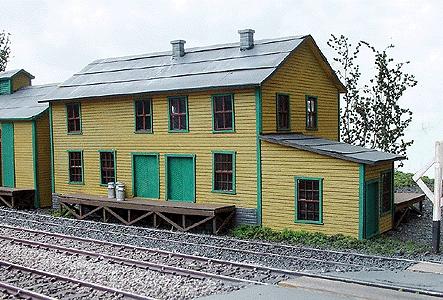

Then MAYBE this kit for the creamery

Joe, that milk platform would only be used for a top with no passenger or freight station. There were some of these in New England but they were not common and were located out on the main or branch, not anywhere near the creamery. If you're not planning a town with a station, a milk platform would make sense.
The BLI kit would be pretty typcial of a small 20th century creamery. You can easily run another track around the back so you can do offloading and loading at the same time. I'm not sure what you mean by a loop but the most logical way to handle the track would be a siding behind the creamery and an additional siding in front fo the sreamery. You can run a switch off the dront side track to the rear track and connect it back up to the front side track with another switch. If you're modeling a low traffic branch line, you could just have all the unloading done while the train was on the main but you really need an additional siding to hold the cars waiting to get loaded with empty cans.

Yes, anything that has a platform. Milk cans aren't picky except they don't like getting hot. That's the one thing I don't like about the BLI milk platform. I'm sure they left the roof off to show more detail but almost any kind of platform that was used to hold loaded milk cans would have some kind of covering to keep the sun off. Milk also doesn't like to freeze so many New England stations that handled regular milk traffic had a milk room that provided shade in the summer and was heated in the winter.
