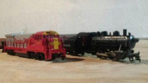

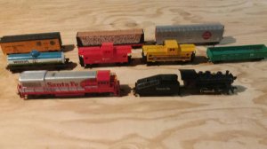

no problem I will take a pic of all the locos and cars I have and post em up
This is what I have right now. The goal is to have a theme based around the Rocky Mountains going from Jasper to Vancouver. My layout is 14 x 6 at the moment but will expand eventually. I am looking to do modern Via Rail passenger train. I have no interest in DCC as I am more about layout than sounds and lots of cars.

I was just curious about what you had now for power. The ATSF diesel is a Bachmann U33B or U36B, and the steam loco also appears to be Bachmann. Both are DC powered.

I am confused, you have no interest in DC? Do you mean DCC by any chance?
You know, there are quite a few modellers who have no interest at all in running trains and are very content to build dioramas for static display and photographic opportunities. Although not exactly in that category you should look at this thread http://www.modelrailroadforums.com/...ing-the-Pinacle-Creek-Mining-amp-Timber-Co-RR. There are 2 layouts in here with the second now in a gauge renewal/alteration stage. Lots of ideas from someone (and others) whose main motivation is photography.
ooooooooooooops my huge mistake,....I have no interest in DCC is what I meant to say. Little dippy here lol
I figured that is what you meant - that being the case, you an pick brand new MRC Power Supplies for $30 or so. While I run DCC, I have an MRC for my accessories, lights etc. It would be perfect for a DC system though.
