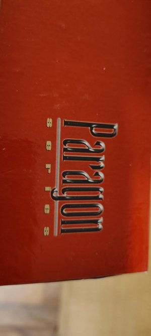

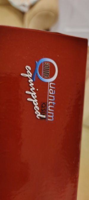

I recently picked up a pair of new in the box older BLI Paragon locomotives, they were at a really good price so I thought I'd give them a shot and they were obviously new, never run. I put the first one on the track, it powered up and worked great on address 3. I also tried it on DC as well and it worked as expected. I then put it on my programming track to change the address to the road number, it responded accordingly to programming, I then put it back on the main and nothing, no sound, no response to commands at all on either the road number address or on 3. On DC it still works perfectly, completely dead on DCC. I tried setting CV8 to 8 to reset but no change. I'm using a Digitrax DCS50.
Any suggestions? I've attached a couple pictures of the box so you can see exactly what it is, let me know if you need any more info. I'm reluctant to try the second unit until I figure this out.
