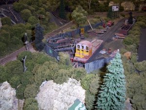

Notice the slight weathering to the flat car and heavier weathering on the old cab.
