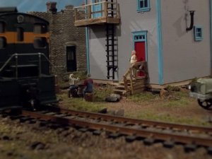

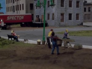

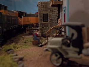

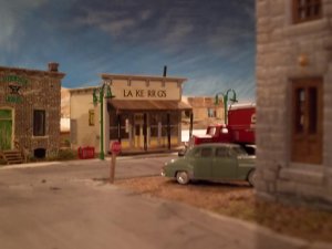

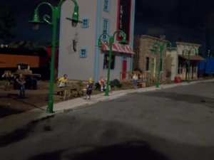

Some pics of the new people just arrived on the layout: Farmers market, full figured folks, better view of the checker players:
Steve-- Thanks for checking out the video. Wish I would have had more room for the yard, but it fits the rest of the layout.
Lynn, Chet--Thanks for the compliment. I have lots of vehicles coming in the mail, hope to fill the industrial area up a bit more. Also, will fit in more people when I see stuff that fits in well.

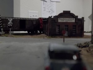

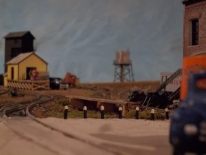

Some pics of posts added to the edge of the parking lot, from my youth I remember these, a black short post with the top painted white, about 9" in diameter, placed on the edges of parking lots or at a cliff or sharpcurve...

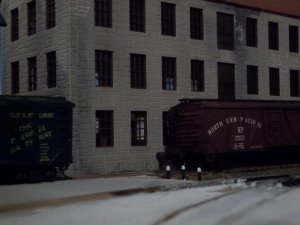

Pics of some more posts and a couple stop signs:
Saw an old film clip of road construction done in 1958 and these posts were in there, although the white went a little further down:
Thanks for looking!! lasm

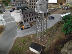

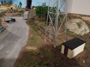

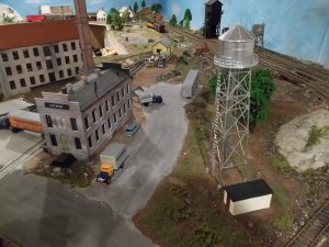

A couple pics--newly added water tower and pump house
The pump house is all reinforced cardboard (cereal boxes) and brush painted and textured to look like stucco:
Thanks for looking!
