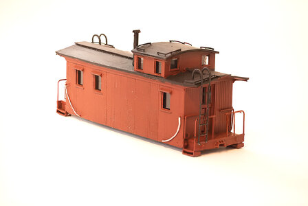

Caboose printed mainly as one piece. End ladders and stove chimney as separate items.

I added windows and truss rod floors to several cabooses today. I tried several methods, the main two being fishing line with printed turnbuckles and the other steel piano wire bent to shape. Anybody out there with other truss rod construction methods?
The one that comes to mind is a variation on the fishing line, in that you melt and flare the ends of the cut line before threading them into the turnbuckles, thus keeping the center of the casting open. Then the usual finish going up through the floor and twisting them back together to proper tension (unless gondolas or flats).
One other "turnbuckly" detail is lining the openings up so you can insert a a common wood plank between two adjacent castings--a 1" x 4" or similar, thus preventing one or both from spinning and creeping back as the tension (real world) comes and goes. I've seen real world photos of that done--perhaps on the Rio Grande Southern, the narrow gauge railroad I followed the most closely.
Your windows look good, and the broken pane is an eye-catcher. Might want cardboard, a stolen pallet, or even a scrap of bed quilting for cold weather. That last one would be a detail I've never seen before, in fact--I just thought of it while typing.
