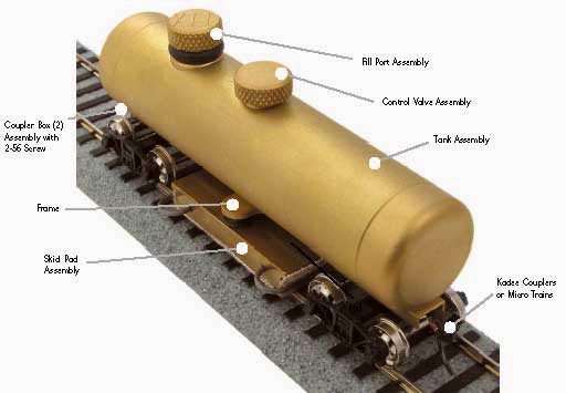

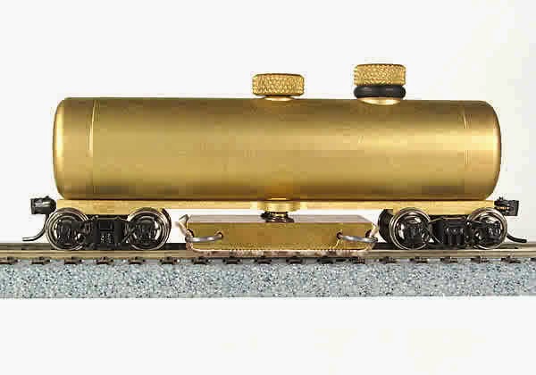

I use a Tonys CMX+ track cleaning car. Its made of brass (8 ounces) and you need two large diesels to pull it around the layout. It does a fabulous job of keep track clean .

Brad:
You could either push or pull the CMX+ track cleaning car.:cool:

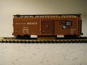

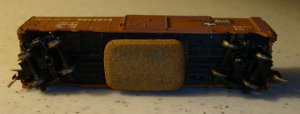

I built my own.
This worked for me. You probably have all the things needed. I used an old Bachmann 41" Steel Box Car, a couple of nails, a piece of an old BrightBoy and 5-minute epoxy to build mine.

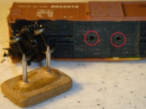

I removed some of the undercar details with my Dremel to provide clearance and a flat surface. I drilled a couple of holes in the car underbody frame for the nails to pass through. These holes were just larger than the diameter of the two nails that I used so that the finished pad would move freely up and down.

I shaped the my near worn out BrightBoy to the desired size and thickness before epoxying the two nails to it.

The weight of the pad is heavy enough to do a good job of keeping the track clean, but doesn't hang up on the turnouts and such. This certainly won't eliminate cleaning your track by hand, but it does maintain it for quite a while.
