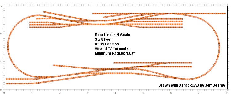

Here's a N-scale version of the 2009 Beer Line track plan using Atlas Code 55.
The original HO plan was drawn with #5 and #6 turnouts. There is no #6 turnout in Atlas N-scale Code 55, so I used #7. This changed the track geometry somewhat, so the plan is not an exact duplicate of the HO version.
I omitted the curved turnout on the left side, and I made no attempt to preserve the modular nature of the original track plan.
- Jeff

Thanks Jeff,
I like the Atlas track plan. That's what I am looking for . . . something I can use to buy the track and components to build the layout without over buying components and track. I wonder if Kato track is any closer to the HO track? What do you think?
Hi Aaron -
The layout above requires the following Atlas Code 55 N-scale components.
7 | Atlas 2050 #5 LH Switches
7 | Atlas 2051 #5 RH Switches
5 | Atlas 2052 #7 LH Switches
3 | Atlas 2053 #7 RH Switches
17 | Atlas Code 55 N Flex Track Sections
I imagine the layout could be built with Kato Unitrack, but it would look a bit different. Unitrack has #4 and #6 turnouts, and it does not offer flex track of course. I'm no expert on Unitrack, so perhaps someone else will jump into this discussion with some comments about Unitrack.
- Jeff

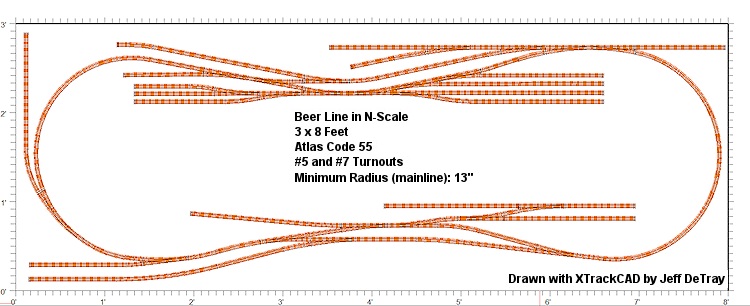

Here is an improved version of the N-scale Beer Line, still using Atlas Code 55 track. This one is a little more faithful to the 2009 HO version.
This version includes the curved turnout.
Parts List:
8 | Atlas 2051 #5 RH Switch
2 | Atlas 2053 #7 RH Switch
1 | Atlas 2059 21.25/15 RH Curved Switch
18 | Atlas Code 55 N Flex Track Sections
It's worth noting that Atlas N-scale Code 55 track is currently out of stock at many dealers due to production problems at Atlas' Chinese factory.
- Jeff

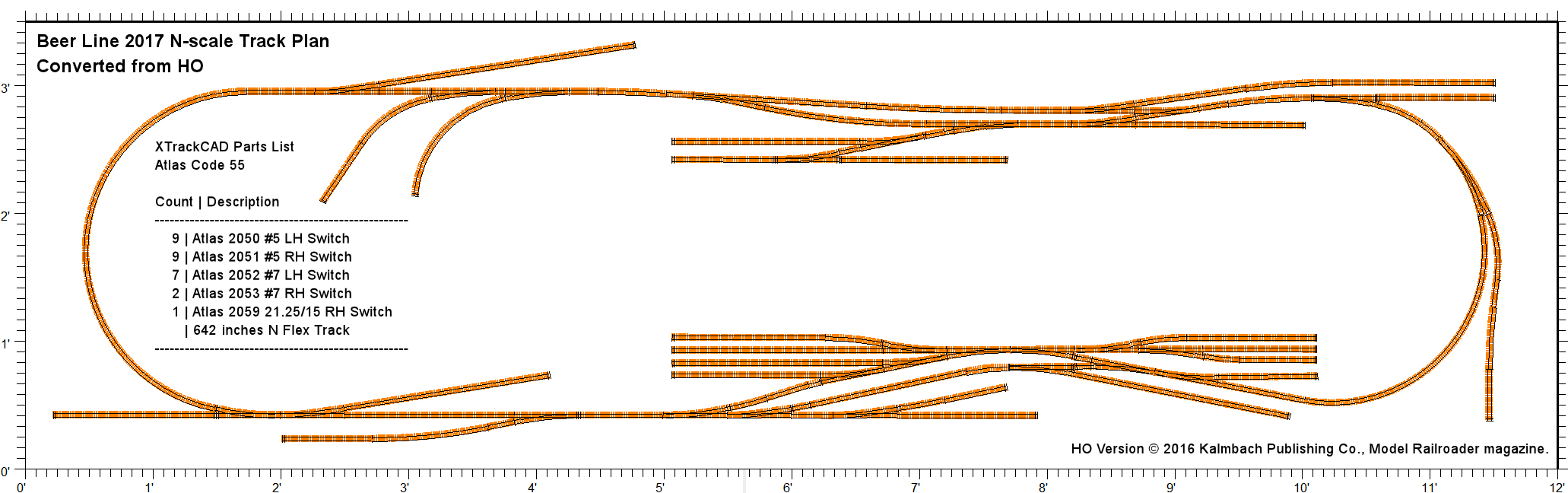

For those who may be interested, here's the 2017 version of Model Railroader's Beer Line layout in N-scale, using Atlas Code 55 turnouts and flex track. The track plan is laid out so that with minor modifications it can be used to create a modular version of the layout similar to MRR's HO Beer Line.
I have attached the XTrackCAD file for this track plan.
- Jeff
