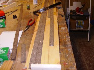

Back to my Northern Pacific layout. I have ordered a few of the things I need to get started, the turnouts: one #6 and two #4 are on their way, along with three Caboose Industries ground throws with contacts for powering the frogs. I needed to order track joiners and I bought some with red and black wires attached. I have bid on 25 Midwest Cork Road bed pieces on Ebay and am wining, so far. I have never used Midwest's Turn-out pads, I've always made them from the regular cork road bed. Tomorrow I will order my Atlas Code 100 Flex Track. I only need twelve; but, have to order 15, as it is sold in Packs of 5, 10, 25 and 100. Since this is going to be for staging, Code 100 with black ties will do.

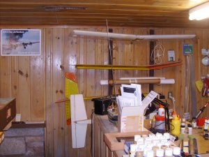

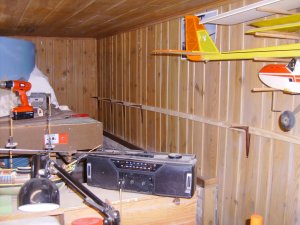

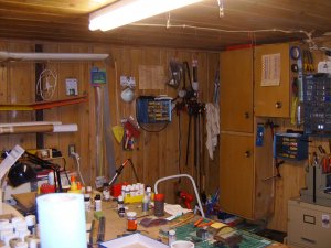

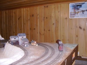

I have taken a few photos to show where this new Staging yard is going to be located.
The first photo shows where the staging tracks will connect to the layout. Where the freight cars are stored right now will be the lead to staging. The track under the cars will be shortened and a #6 right hand turnout will be added to the shortened track. This track may be straightened out a bit, making it more parallel to the edge of the layout. The the staging track shelf will run along the knotty pine wall and be six inches wide.
In the second photo, you can just see the edge of the layout. The staging yard shelf will be at the same level as the layout at this location. You can see the storage area I use for off layout storage of rolling stock above the flagstone partial wall. The model airplane storage rack will be cut in two just above where the staging tracks will run and the bottom half of the rack lowered to get it out of the way.
The third photo shows where the end of the 9 foot section of staging will be after some stuff gets moved out of the way. It will end just behind the the cabinet, visible to the right of the center of the photo.

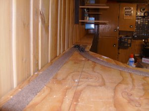

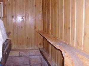

Photo #1 Shows the shelf brackets and furring strips for the North end of the new staging yard. Although the Knotty Pine paneling isn't very straight, it is good enough for what I want to do. Photo # 2 shows the connecting piece that will allow trains to exit the main layout. While looking over my design, I thought I might be missing out on an operational aspect if I didn't make the Wye into an operating wye for turning trains or locomotives!

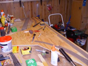

There really isn't much junk on the layout, the crap you see, is on my work bench. I am laying road bed on the wye part of the addition in the 2nd photo above.

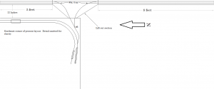

Here is the latest and greatest drawing of my new addition to my layout. Although the lengths of the tail (Storage) tracks has been given, I really don't know their true length yet as the actual length of the Wye is known; but, hasn't been subtracted from the tail track length, yet. Also I need to determine where to put the rail gaps for the Auto Reverse device.

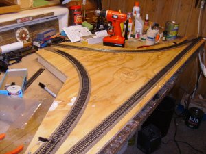

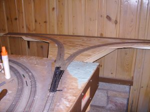

Here is photo of the Wye and the #6 turnout just laid down. When I designed this new portion of my layout I considered making this part of it a lift-out section. While thinking about this, once I actually started construction, I decided all the complications of making it a lift-out section, just was not worth the extra effort. Also, it is very easy to duck under this section as it is at least a foot higher than my other duck under.

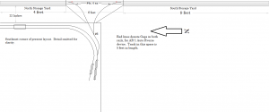

Here is what I think will be the final draft of the addition to my layout. Click to make the drawing bigger.

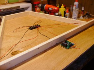

I am about ready to move the wye section to its' permanent home, so I took another photo of the tracks on the top, flipped the panel over and took another photo of the underside with the AR-1 Auto Reverse device mounted and wired up, ready to go. The black item that the wires go to in the center of the panel is a screw terminal strip. Yesterday, I ran out of #22 black insulated solid wire, so I went to town to get more and was unable to locate any. We used to have a Radio Shack in town. They went out of business at the same time Radio Shack Corp went belly-up. That is where I bought my wire before. So I ended up using red wire and put black bands on it to identify it as black. My Ace Hardware barely had any solid copper wire in lighter gauges and none of it in black, red or green.
