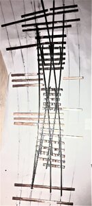

Here is my new project to build a set of switches for entering the station on a curved line.
Here is the initial plan and a long radius crossing already done first =
All the switches will be placed on the left, just after the viaduct in the curve where there is a station =
... throughout the manufacturing process =
And Finished work and remains to weld the last needle blades and the electrical cuts =
263.2 KB

Wow that’s quite an undertaking, looking forward to seeing the results!
Wow! This is real engineering in model form! Very impressed by the quality of your track work. I can see an Austrian coach on your layout - are you in Europe?

Wow! You know there are some nice turnouts commercially available?
Just kidding. Great work!
Thank you very much for the appreciations. No, unfortunately these switches do not exist on the market. However, if you really need a custom-made switch, I can make it for you and that would be happy (free of charge). Best regards

Got to hand it to you-very ambitious trackwork. Unusual too. Will be something to be proud of, once finished. Nice collection of TEE, OBB, etc equipment, too. Looking forward to seeing more, going forward.
