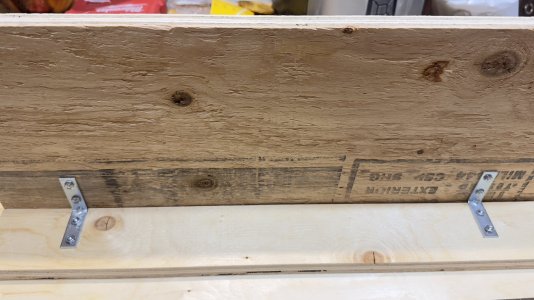

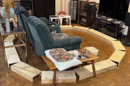

Well, after some tricky situations and lots of learning experiences, I completed my wooden train platforms, which I call a "modular" design, because it consists of sections of independent plywood platforms, encircling our couch where we watch TV in the basement.
The first few photos are of the hardware I used to assemble the "legs" to the platforms. All the platforms are either 4ft, 3ft, or 2ft. long, and 12" wide, with 3-inch legs on either side. So the height above the floor is just 3", but this is enough to ward-off dust. I used #8 - 1" machine screws and nuts. However, during assembly and after I had purchased all the hardware already, I realized that I may have used the slightly thicker #10 screws instead, to better fit the holes of the L-brackets (sold here as "corner braces"). But it worked anyways, since the weight they carry is quite minimal.

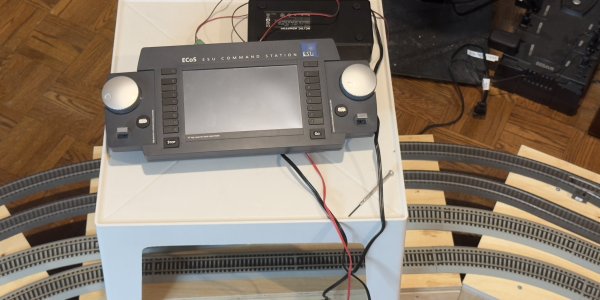

There are two systems running here: Bachmann DC 2-rail (grey tracks), and Marklin AC 3-rail (black tracks). The DCC controller is the ESU Command Station 50210 (previous generation).

That is an original idea, does it actually make a loop?
I would like to see the trains...
Dave LASM
Dave LASM
Thanks Dave.
Yes, it does complete a full loop with the tracks. The section that you see missing here is our "door" to access the couch LOL! I just remove the tracks as one bulk section and the corresponding platform section and voila! The only thing is a slightly uneven floor at places, where I have to adjust the height of the platform section to try to make it even with the others. Otherwise, the solid hard plastic "bed" under the tracks is sturdy enough to support the trains around the turns. I just make sure that no track joint falls on the empty joint space.
Neat! I've never seen something like that. Don't trip over it 🤣
Yes, that was how my idea came to be. You see, the original layout was basically the same two systems, four tracks in total, encircling the couch, but on the floor (ew, the dust!). I just remove one platform section and the tracks on top to have a 2-foot access way to the middle and to the couch.
That is certainly different than the typical German carpet layout. Seems to work well.
I like the Croc and the French Diesel you have there.
Thanks! But I guess I am aware of the limitations of such a design, which was done precisely because of the limitations of our home setup, without a dedicated room or space for a large area train setup. I can't really do complex layouts but I may be able to extend the modular platforms to the MIDDLE of the setup at a 90 degree angle, connecting the front (TV side where you see a black amp in the videos) to the back. Since we removed the couch that used to be there and have two recliner chairs now, there is a large enough space in between them which I can definitely use for this connecting track.
