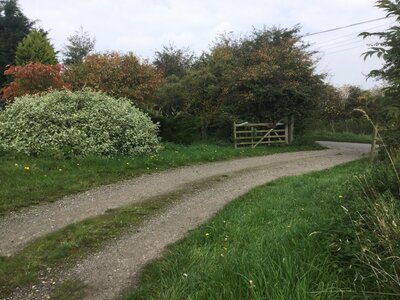

Love it, unusual and a real talking piece…..plus I have gates like this and after seeing you may consider something similar….you may have started a trend/fashion
I love the ingenuity.
