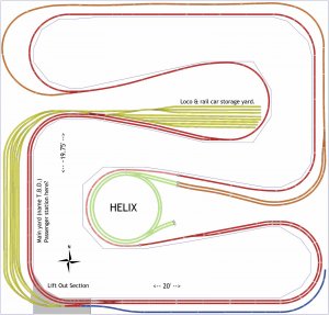

Here is the plan for the layout as I have it currently. I would love to get some feedback on design, and if there are any major problems that I should change right away.
This is the lower level of the layout with the main line in RED.
The ORANGE line in the north end is the grade leading into the bottom of the helix.
The BLUE line in the south end is the lead heading into my staging yards and reverse loop that is hidden below the first level.

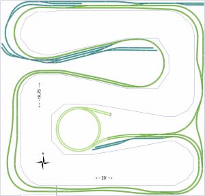

This is the upper level with the main line in GREEN.
All the TEAL lines are industry lines and sidings.

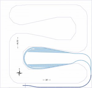

This is the sub level where I will be staging and storing all of the trains that I don't have... yet.;)

However, I would think you may want to minimize the number of tracks on the lift out section. While it may not be possible, if you "reverse" the mid level north and south sides of the layout, you would only have two tracks in the lift out. Again, I know very little about it, but I think you would want to have as few tracks as possible on a moving section.

I know what you are saying, and I did try to reduce the amount of tracks and turnouts on the liftout. The only parameter that is not set in stone yet it the placement of the door. I can move the door up to 6 feet to the right of where I have it now, and that should solve that issue.

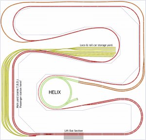

OK so I have made the change to the lift-out section on the layout to roughly 6 feet to the left of where I had it. I don't know why I never though to move it before. I can not move it any further to the left due to an exterior wall that runs perpendicular to the south wall of the layout room. I think this will be good though. Thoughts?
This looks like a very interesting plan and you sure can get a lot of railroading done with this plan. The change in the lift out section was a good modification. You could also make it a drop down by hinging at one end. With the area you have to work with I am assuming that you are going to go HO scale.

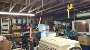

I wish I had some picture that were not quite so cringe inducing, but I don't. But here ya go.
This is the wall where I will be placing the entrance into the layout room.
This is the location where I plan to set up a small work bench.
This is the current door into the space where the layout room will be. This door will not be used for the purposes of entering the space and will be semi-permanently locked and covered with background board.
And here is the space where the layout will reside. I think I have a few "things" that may need to move first.
