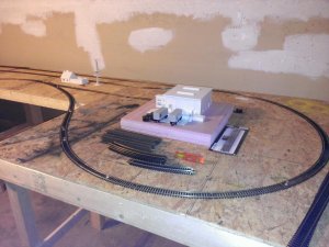

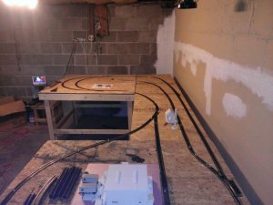

New guy here...with my first layout attempt. Curious if this would be good for a basic "operations" layout. There is a picture of the coal mine I built but couldn't fit it to the layout...so I'm going to add another 4x4 piece. One side will be 4x6 the other side will be 4x8, the 2 joined by a 2x4 piece. Any suggestions would be greatly appreciated.
In your last picture you've got that funky double curve. What's that for? It seems unnecessary to be honest. You could definitely add more industries if you want to do switching. The insides of the curves would be good places for something like that. Overall it's a nice start

Your layout looks to be a basic roundy round type meant to just run trains. Doesn't look like you've "cast in concrete" the tracks w/ glue & ballast so you can salvage them easily. Take a look at the many track plans on this & other forums to find one that you like. Also there's a gazillion plans already on Google. Do a search for plans using whatever parameters you want.

Looks like you have the room to add a grade up to a second level. That would add a branch line for op's and you could use that coal mine up there.
It would also give you a little hidden track for the illusion of getting somewhere.
I'd also get rid of the double curve. You could double track by joining that "curve" to your inner line then run a side track of that for your industry, switching yard or whatever.

If this is your first layout, consider this. Just temporarily attach your track and don't ballast it. Put out some industries and buildings and see if what you planned will work for you. I don't know of any model railroader that was happy with their first layout no matter how much planning went into it. You have a good start and plenty of room so don't tie yourself into something that might not be satisfying in the future. It will also give you some running time to determine what type of "operations" you really want. Dave H has plenty of good thoughts for you to consider. Another observation I have is to watch those back corners...they will be very hard to reach!
