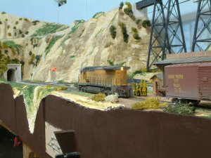

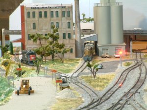

View of Maywood from the Southern end of town

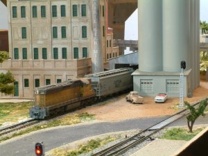

Flour mill and grain silos on the Northern edge of town
Dash 8 #9225 switching Hillside Timber mill

I think you've done a great job of capturing the flavor of a rural area in the southwest. I'm looking forward to more pictures of your layout. A really nice job, something to be proud of.
That is really nice work and, as Bob said, you have captured the rural atmosphere very well, especially with the "wobbly" track - it looks very good.
I agree. This could certainly be Utah. I'm impressed with the overall quality of Australian layouts and modeling!
Just realised you are a fellow Aussie and this is only your 4th post. Welcome to the forums and, as said, your work is great.
I think you've done a good job on your layout. It definitely looks "US." As for photos I recommend Photobucket as a host site for your photos. From there it is simple to have full sized photos posted here. Jim

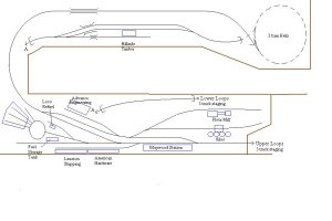

Here is a basic layout schematic.
The Upper and Lower loops comprise 3 off stage staging loops each, these feed trains onto the main layout area
Overall Size : 20' x 10'6"
Min Radius : 22" in helix and Staging loops
24" main layout
Turnouts : Peco Large Radius & Curved Turnouts main layout
Peco Medium Radius staging loops
Control : DCC Digitrax Command Station and Booster
Soundtraxx Tsunami decoders in all locomotives
All turnouts are controlled by Peco solenoid switch motors and Digitrax DS52 accessory decoders
Turntable is controlled by Digitrax DZ123 loco decoder
Train location is detected by Digitrax BD4 block detectors.
Turnout location is monitored by Peco accessory switches
Layout control is by Digitrax Zephyr DCS50 command station via DB200 8A booster
The layout is divided into 7 power districts via Digitrax PM42 power management units
Signals are controlled via home-made interface circuitry connected to Arduino Mega 2560
The layout is designed for single person operation and consists almost entirely of short local freights.
Motive power consists of a couple of SD24's, an SD26, an SDP35, two Dash 8-40C, a GP15 and a GP38-2
It looks like a very well though out plan. Before I started my layout and put down the first rail, a lot of planning was done and now that all track is down, the planning was well worth the time and effort.
