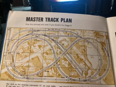

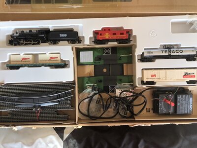

Thanks for the info, I’ve already ordered most of the track, I didn’t think about using flex track. I’ll for sure use it more when I expand. Here’s a poor pic of the layout. image.jpg
Hi magilla12,
I'm guessin' the transformer (and the set) was made by Mehano, by looking close at the transformer in your picture. Looks like they included a fair amount of track in the box. Maybe even more sections than the ubiquitous starter set oval that's usually included with the average train set?
As I said previously in another thread, I've always kinda' liked that plan (I also have the book). The grades may be a little steep, thereby limiting you to short train lengths. And also once again, it's a great plan for learning the basics, including grades and reverse loops.
Are you planning on building the layout in stages, as depicted in the book? Or will you skip some of the early stages and start out by jumping in right away with stage 6? Or other? Keep us us posted!
Hi magilla12,

Any chance you can change the dimensions from 4x8 to 5x9, and then grow the layout from that size? Or even 5x8, or 4x9? I've found over the years, that going from a 4' wide to 5' wide layout, can add a lot in terms of the size of locos and rolling stock that will operate reliably. That includes lengthening/reducing grades, and things like that, which mean you might be able to operate longer trains, or trains at more realistic speeds. Plus more space, means maybe another industry, or more space for scenery in general.
I would if I could find a 5X9’ sheet of plywood. Grade is addressed in detail in the book, as is a 5x9 layout. I’m still in the planning gathering phase so anything is possible.
5' x 9' layout addressed? Sorta' kinda'. What they show in the book is the 4' x 8' layout super-imposed on a 5' x 9' table to simply show more available room around the outside of the track plan for scenery purposes, and/or possibly throw an extra siding or two around the outside of the track plan, as opposed to enlarging the actual plan with larger curves.
On a 5' x 9' table, one might be able to go to 22" radius curves instead of the 18" curves (and you might have to go to 5' x 10' in order to achieve this), but now we're talking more time in re-drawing and/or re-scaling the layout in order to make sure that everything works out properly. Scaling up the curves? Not a problem. But scaling up the Snap-Switch turnouts with their built-in 18" radius diverging track? Oops - unless we hand lay our turnouts, that's gonna' start presenting problems.
For anyone's first layout, they would probably be wisest to stick with a proven plan and leave custom modifying for later on down the road after gaining some good, initial experience. Plus they'll be up & running a lot sooner! 👍
It also says you can add 6” sections of track at the locations Z on the master plan to stretch the track a little.
Oops on me! I looked through my book last night, and forgot about that one. 🤪
I guess I got off on a wild hair about going with larger radii curves. Which allows for bigger locomotives and rolling stock. I'm always an advocate for going with larger curves and bigger turnouts whenever/wherever possible.
By all means, if desired, you can go with a larger table and add 6" straights where shown, because since this is noted in the book, it still fits the category of a "proven plan". 👍
