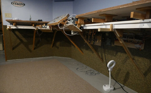

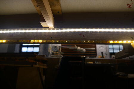

Here are pics of the strips temporary mounted to the 'L' girders under the layout. These have adhesive on the back that actually might hold for the long term, but I will probably apply clear (or white) acrylic caulk as a additional measure.
I needed around 27', so I either cut one of these or overlap where they meet in the middle, starting the ends of each strip from the ends of the table. I believe the actual length of the strips are more than 16", but haven't measured yet.
One strip is decent, not bright, but workable. With both strips in use, output is more than enough telling me a 5050 strip as opposed to this 3528 would of been the better choice.
If you focus on the top of each pic, the single strip really isn't that bad, ignoring the carpeted wall that sucks up light, making it look much darker. Finally, the "warm white" is very pleasing. I wouldn't want the common so called "clear or true white".
Though, I surely didn't need "waterproof", I find this encapsulated strip a huge advantage over a bare flexible circuit board with LED's & resistors exposed to getting hit and damaged. I'm not sure about mounting as I'm concerned if either strip fails and needs replacement for whatever reason. I was planning on applying acrylic caulk to supplement the adhesive strip, but I'm not sure now. using pieces of 24 gauge wire does hold these in place, but needs refinement.

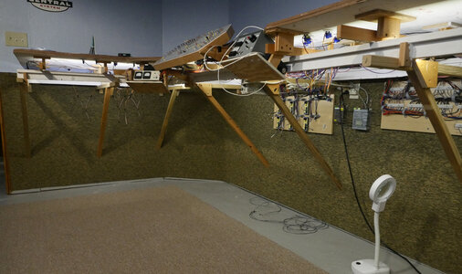

A late reply and a update on the problem.
My guess is 3 fold; cheap design/materials, excessive heat from being weatherproof (encapsulated) and possibly ($$) over voltage. More sets (three at a time) have gone dark which tells me it's the resistor.
I bought 3 more reels, but will wait until more go dark before i remove these, there are other priorities. :(
Update on the dying LED strips problems.
I removed a 2nd strip where half the LED's died and replaced it with a new strip. The old ones were around 32500 degrees kelvin, the new ones are around 4000 deg. K which looks better (and brighter).
The last existing strip cover the far end of the layout and most of those are still good. I also put a adjustable PS in and adjusted the voltage down to 11 vdc. Hopefully this won't repeat the previous problems with those apparent cheap strips with little QC.
Note the comparison between with and without the lighting and the two strips (old on bottom, new on top).
