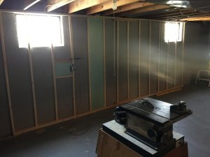

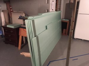

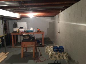

Last night we got the basement wall that the primary length of the layout will go sealed off. Next up is putting in the 2 x 2 and 2 x 4 framework to hold the pieces of insulating foam board in place. After that we apply the always fun inside the home bug shield to help debugify the basement.
2 x 4 and 2 x 2 grid is in place. The foam board sheets cut to size are just sitting, waiting to be glued into place. We still have to spray the entire room with the bug treatment.
Gridwork on the wall will help me mount 1/4' facia for a backdrop along that wall, as well as giving me manageable sections of the foam insulation to work with. Next week with a couple of bug treatments in place it's time to start building my benchwork frame.
I have to admit it's nice to be getting to the point where I can actually see progress being made instead of just ideas running through my mind.
Scott:
Great progress and real craftsmanship in your carpentry. Looking forward to seeing your bench work and other projects.

Notice all the pictures are from a distance. :rolleyes:
If I posted close-ups you would beg to differ. But thank you. Having done the woodwork that I have this week, I'm almost scared to start working on my benchwork, but i know if I just take my time, measure twice cut once, and all that, I'll be able to be successful with it.

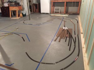

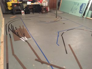

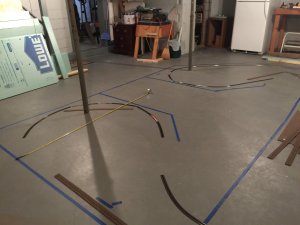

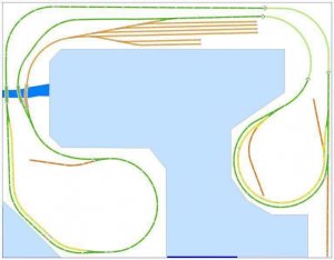

So I have the space ready, and I did a trial setting up of my track, very roughly as you will see in the pictures. Good thing that I did because the track plan and benchwork that I was planning on using wouldn't fit because it was found on the internet with NO specifics as to what the relationship to the area and the dimensions of the benchwork wasn't listed anywhere.
So instead of using this plan
My plan will now look something like what is shown below.

Scott, it looks very nice for the space you got there!
In the center of the layout, this is a small yard right? If it is, have you considered moving the ladder a bit to the left in order to add some extra length to the yard tracks?
Looking forward to see this progress! Thanks for posting!
Yannis

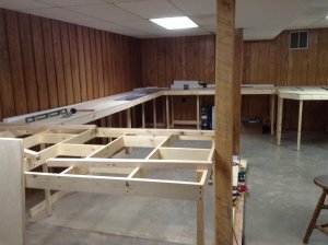

Just thought I'd join this conversation. Your progress looks great. I am in the middle of my first build. It's a 20 X 14 space in a basement room, and I have two posts in the middle of that room, very much like you have to contend with (see photo below).
The photo is pretty old, taken in December. Since then all the benchtops have been installed and most of the track is down. (Hmmm - guess I need to take a few updated photos!) The only part of the bench work that isn't done yet is a peninsula that I'll build between the two posts and around the far post.

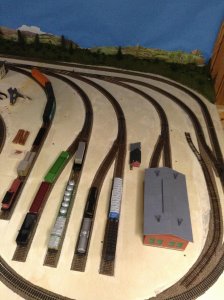

I also had to build a freight yard with some size constraints:
This section is 6 X 4. I may try to redo the ladder by moving the turnouts further back (toward the inside line at the top of the photo) and that way I could get a few more cars in. But I can't have real long ladders on this layout.

Thanks Yannis!
I probably am going to be moving the ladders left some, how much, I'm not sure. But yes, they will need more room. Thank you for the suggestion.

Scott,
Thanks for the compliments. I actually started the build in a smaller, unfinished basement room with terrible lighting. I hadn't got very far with the build and one day my wife said why not build it out in the large family room (the one with the dropped ceiling and nicer lighting). I said thank you to the "land baron" and that's how the build ended up in that nicer room.
I actually studied photos and especially videos that other forum members posted before I started the benchwork. Learned what worked and what didn't, got lots of suggestions about materials to use, sizes, etc. These forums and the guys out there have been great to make suggestions and to show their own layouts to help rookies like me.
I notice you are curving your track around both posts. That's a neat idea, and seems like it will give you a longer mainline. I'm having my main line go down the peninsula (that isn't built yet) between the two posts, and will curve around the far post and come back. I have a town about half way down the long wall on the left (in the benchwork photo), and will build a very small village around the far post, so it will kind of be a point-to-point layout, although it really functions more like an out-and-back servicing a number of trackside industries as well as the larger town.

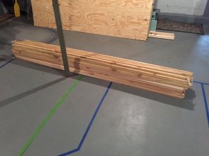

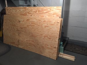

Well look what showed up in the basement this week.
I guess I'm going to be building soon. Exciting and yet a little scary as well.
Q: How do you eat an elephant?
A: One bite at a time.
You'll be fine. There are very few things in this hobby that can be screwed up so badly they can't be fixed. Just take your time. You're in a marathon, not a sprint race. ;)
