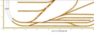

So I have some questions on wiring. The first picture shows the locations and polarities of the power feeds to the track. I have denoted where the feeds will come from the output of the auto-reverser. Does anyone see any errors or the need for any additional feeds, i.e. between turnouts at crossovers? I am using all Peco insulfrog turnouts which are power routing.

The second photo is an excerpt from the DCCWiki page. It indicated that I should not have complete loops in the bus or rail. Is this critical or something that is negligible on my size layout. If it is critical, I will need to try to get insulators on the inner and outer loop which I currently do not have. Any thoughts from the experts?
I cannot answer your DCC question since I operate DC only. From that perspective, as long as you are running one engine and one engine only, this will work. The entire layout will be live at all times unless there are insulators that are not shown. If you plan to run two controllers and two engines, one each on the inner and outer loop, then you will need insulators at the two crossovers to separate things. There is also no provision for parking any additional locos on any sidings. Again, this may not be an issue if you only have one engine. You also did not state how long you are going to operate DC.
The reversing section is rather short. This is not a problem if every train is shorter than that section. If any are longer and you have metal wheels on your freight (or passenger) cars, then there will be a momentary short whenever the wheels cross the gap, as they are in contact with both rails. This won't be too noticeable in DC (a few sparks) as it is more forgiving than DCC, unless you stop while contact is being made. Some DCC systems may be less forgiving.

Not too long. Just until I get some more track installed and tested. I acknowledge if I was staying with DC, I would need many more insulators at all the storage tracks and between the two loop crossovers. I don't believe those are required with DCC.
Unfortunately I am space constrained and couldn't make it any longer. My longest storage track should be about the same length as the reversing loop between the insulated joints. If I did marshal a longer train, I would ensure there were no conductive wheels near the end of the train.
Nope, looks good to me, other than the set of feeders between the turnouts on the center of the top. The general rule of thumb is that one feeds power from the points of a turnout which you already have.
No, for a layout this size what you have is fine. I've done layouts much larger than what you have without insulation of any type. In fact, I believe you have more feeders over all than I have.
Thanks for the tip on the extra feeder at the top. I was thinking that I have a few too many feeders. Not too difficult to install them so I might put them all in except the one.
