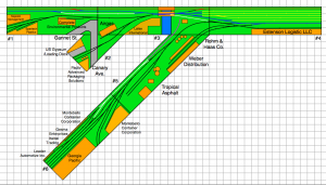

Hi guys, this will be the thread where I post my progress of building the small HO Scale switching layout i have been planning. It consists of 6 modules (each numbered in the attached trackplan), which their dimensions are as follows:
Module #1 is 78" L x 24" W
Module #2 is 45" L x 24" W and is at a 45 degree angle
Module #3 is 96" L x 24" W
Module #4 is 96" L x 24" W
Module #5 is 96" L x 24" W and is at a 45 degree angle
Module #6 is 82" L x 24" W
All track is Central Valley Tie Strips with Micro Engineering Code 83 Rail. Turnouts are Walthers Code 83 #6, #4 WYE's, #6 3-Way Turnout, #6 Double-Slip & Atlas Code 83 12.5 Degree Crossing. Minimum Radius is 24" throughout the plan
**The top Orange rectangles that cross the Blue Rectangle on Module #3 are bridges. The Blue Rectangle is the Drainage Ditch. The Top Orange Rectangle will be one of the BLMA Concrete Segmental Bridges, the bottom Orange Rectangle a Plate Girder Bridge.
**All other Orange boxes are Buildings (each building has the company that occupies the building in or next to it)
**Red Lines are the BNSF Mainline. There are 2 Mainlines that run through, I have only included one. The mainline will be Concrete Ties.
**Yellow Tracks are La Mirada Yard Tracks. The real yard has 8 tracks, mine has 5
**White Tracks are Run-Around's
**Blue Tracks are Yard Leads or other Leads for Switching
**Purple Tracks are the loco/caboose track
Industries
Ill start explaining the industries from far left to right.
Majestic Management is a company that does not see Rail Traffic. The siding next to the building will be used to store loaded hoppers for Spartech Plastics
Spartech Plastics is a company with 2 unload tracks. Each track will hold one hopper. This industry will have to be switched often pulling empties out then pushing loaded hoppers from the storage track in.
Complete Environmental Products is an industry that no longer receives rail traffic. The switch is partially torn out, which will make for a fantastic detail i think!
US Gypsum receives boxcar loads and has a large concrete loading dock. 2 Boxcars at a time can be spotted here.
Pactiv Advanced Packaging Solutions is another Plastics company. There are several boarded up cargo doors along the back of the building, and I believe they only receive hopper cars down at the other end of the building, which will not be modeled. The 3 storage tanks will be built but again, they are no longer used. Exterior Piping and boarded cargo doors will be modeled on this one.
Airgas is a company that spots tank cars. 3 Cars can be spotted here at a time.
Latex International does not receive any rail traffic
The Small Square Building next to the end of the Purple Tracks is the yard office
Rohm & Haas Co. is the long skinny rectangle next to Weber Distribution. The long skinny rectangle is a tank car unloading platform.
Weber Distribution can spot several boxcars cars at a time
Tropical Asphalt can spot several shorty 2-bay Covered Hoppers at a time.
Montebello Container Corporation can spot 4-5 boxcars at a time. The second Montebello building which is located directly across from Georgia Pacific can spot 3-4 boxcars at a time.
Gesma Enterprises is a industries that spots tank cars. 1-2 tank cars can be spotted here behind the boxcars for Montebello, which is how it is laid out on the prototype.
Italcal Trading does not receive any rail traffic
Leader Automotive Inc can spot 2 boxcars at a time
Georgia Pacific can spot several cars at a time on the track nearest the building. The second track nearest the building is used as a storage track for additional loaded boxcars that are switched in when the needed.
Estenson Logistic LLC can spot several cars at a time. This industry spots cars rather oddly, and each car much be spotted exactly. There is space between each boxcar spotted, so the cars must be tied down individually, which will make for some interesting details.
In my next post I will post the start of Module #4, which is the module I have chosen to start with
