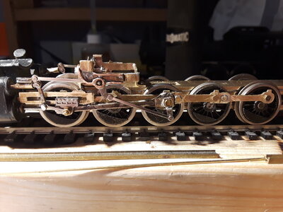

Short film shows the proper valve guides. Had to do them twice because first ones were not providing enough support. Through out the rest of december on weekends i've basically had to fine tune everything, little soldering, little shaving of metal and out came pretty well working mechanism:

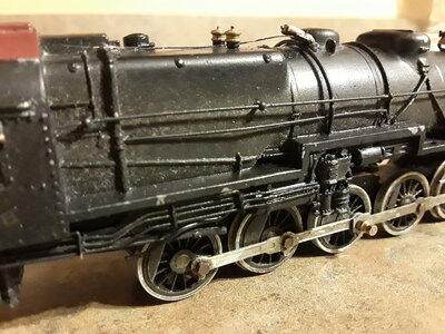

I'm building pretty humble layout just to be able to play around and run some equipment, so to ease off a little work is progressing on kitbashing that Penn Line decapod into L1 mikado. Few days ago finally got the front air reservior with deck on top soldered:
At the same time i replaced that pizza cutter rear trailing wheel with nice flanged dark metal one:

Continuing with the valve gear through mid december:View attachment 160105View attachment 160106View attachment 160107View attachment 160108View attachment 160109
I'm building pretty humble layout just to be able to play around and run some equipment, so to ease off a little work is progressing on kitbashing that Penn Line decapod into L1 mikado. Few days ago finally got the front air reservior with deck on top soldered:View attachment 160116View attachment 160113View attachment 160115
At the same time i replaced that pizza cutter rear trailing wheel with nice flanged dark metal one:View attachment 160114

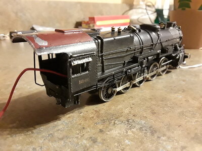

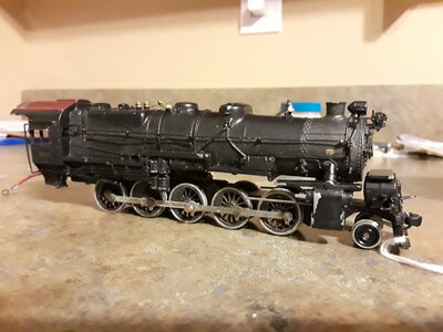

I was at the train show in Timmonium last weekend and must say, really great show. A man was there from New York with a lot of detail parts; steam, diesel and electric. I was able to find just about all details for the decapod, including a pretty rare water pump casting for engineer side under cab placement. The only parts i'm missing for detailing are castings of mechanical lubricators which go under the walkways just after cylinder blocks. Picks from last night after some more soldering and with chimney and some boiler straps done:
I was still fighting stubborn metal on the firebox to get it in shape and to fill up the holes. Have to get this done before i start putting on the walkways. After the walkways i'll be able to start fitting in the accesories.
I was at the train show in Timmonium last weekend and must say, really great show. A man was there from New York with a lot of detail parts; steam, diesel and electric. I was able to find just about all details for the decapod, including a pretty rare water pump casting for engineer side under cab placement. The only parts i'm missing for detailing are castings of mechanical lubricators which go under the walkways just after cylinder blocks. Picks from last night after some more soldering and with chimney and some boiler straps done:View attachment 161662View attachment 161663View attachment 161664

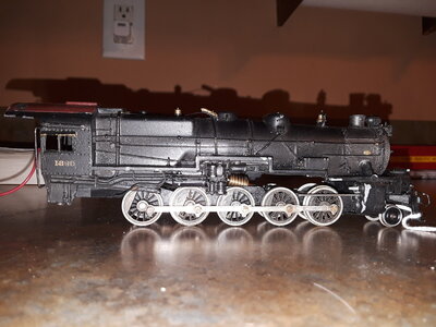

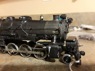

While collecting the rest of details for L&NE decapod i also got the plans for booster eguipped tender printed to proper scale. This past weekend there was a huge train show in Allentown, PA so i went. Scored this old Penn Line I1 decapod which is a little beat up, but has the superdetail kit installed and those kits are hard to find.
Who ever had it last did not know what he was doing, as even the side rods are installed upside down. I was able to ask lower price without the tender. After some fiddling with it hooked up a temporary tender which was generally found on K4 passenger locomotives and L1 mikados. Runs pretty good.
Who ever had it last did not know what he was doing, as even the side rods are installed upside down. I was able to ask lower price without the tender. After some fiddling with it hooked up a temporary tender which was generally found on K4 passenger locomotives and L1 mikados. Runs pretty good.View attachment 163152View attachment 163153
