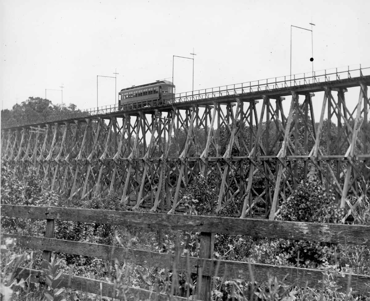

It is not completely necessary to have the outside sway braces. Your bents are close enough together that they should be affected too much. But if you started pulling heavy trains across it, or accelerated frequently on the bridge, I would recommend them. Sway braces certainly add a great deal of realism to a model bridge. Some builders put their sway braces at the very outside of the bent edges, while others positioned theirs on the vertical posts toward the inside of the bent, where most of the weight is. You would still connect these to each sill as normal.
Trestle without sway braces:
Trestle with sway braces on the inside posts:
Another:
But personally, I think a trestle looks best with the sway braces on the outer most posts.
Well, it looks like the consensus is in…I‘ll be attempting to add some diagonal bracing to thr outside of the timber trestle!
