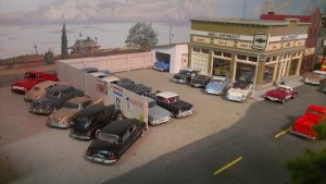

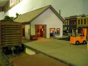

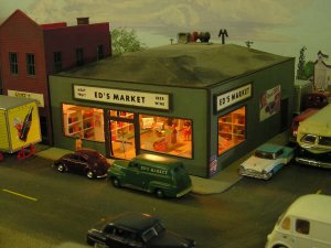

I have a few buildings that I have lit the interiors of, but I also don't run trains in the dark. Lighting buildings even if you don't run trains in the dark is nice if you have detailed the interior of a building. Even with the lights on in a room, lit interiors can add interest to a scene. Here are a few examples. Greg has apparently ordered Woodland Scenics new LED plug in street lights. I have looked at them and really like them, but don't know if I want to pay what they want for them as of now. Time will tell.
