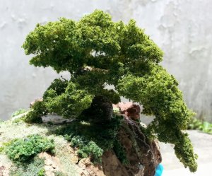

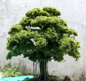

Excuse me I'm newbie from Indonesia, I had followed this forum about more years ago, I like all topics in forums, thank for accepted me be members in forums, I'm So sorrymy english is no good
Welcome NanangHart, Is Nanang your first name?. Is that a picture of a model you have made yourself? Great work. Seems we are attracting more members from Indonesia. Don't worry about your English, looks OK so far.
Yes I do, I had made many models of tree since I had followed this forum, thanks for appreciated
Hello, Nanang! am from Indonesia too, Bogor to be precisely. WOW! your tree looks so real, may i know what do u use for the material and where you bought the material?

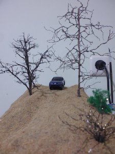

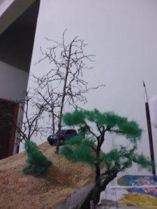

These are my very first attempt on making frames and tree, material used are everything i have in house, wire for the trunk and steel wool (for dish washing) for wrapping the wire and for the branches. The steel wool is so curly and kinda hard to make them shaped properly. Not recommend it but those all i got for now. i cover the frame, as suggested, with diluted white wood glue and saw dust with a little drop of dish detergent. after it get dry i dip the frame into latex wall paint. And finishing with acrylic paint.

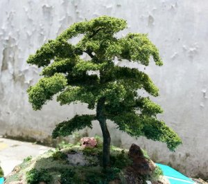

I try to make the leave on one of my frame, it's made of fiber you use for washing dishes, i cut it into very small pieces and pour it with tea sieve onto the glue-sprayed branches, but it seems not quite succeed. The volume seems not right and the color is not as green as leaves.
The tree frames in the picture are on my first diorama ground, made of used carton, the top of shoe box, some toilet paper, white glue, and for the dirt i use saw dust. Later there will be grass on those dirt (when i know how to make grass :D)

Grove Den--Your trees are superb--Scotch pine, now called Scots pine; the other looks like Norway or White spruce.
Narandara--Yours will be that good. They are as good as many now.

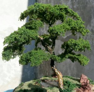

replica fig tree ( bayan tree ) or universal name ficus 6" height
Narandara,
I'm so glad could joined this forum, I bought materials nowhere, cause I made it myself with sponge that blended into small part and combined with spray glue to the branch

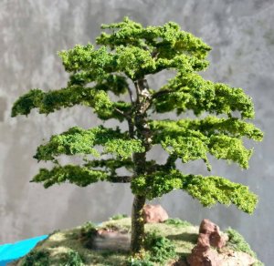

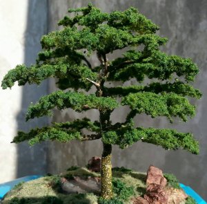

Another models tree I had make in HO Scale about 5-6" height
