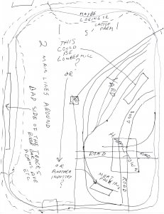

Thanks Chet. I like switching as well. Referring to the photos. Where the trap door is is going to be a small town or country crossroads. With 1, maybe 2 rail lines going thru. This will allow me to get my technique together for the many lift outs I will be attempting. I plan on having a yard from the front of the layout going towards the "pointy" part. I guess I'll post a chicken scratch diagram. And thanks all for the track planning software suggestions. I am more of a put stuff together and see what happens and works. That is why I'm using Unitrack.
Chicken scratched layout plan
HO chicken.jpg Please ask questions and I can explain each part. Thanks.:D

Larry its nice to see you have put something on paper. Are you planning to do any switching operations on your layout or simply running trains and scenic-ing it up? I enjoy building the layout and all that has to do with the journey but also enjoy running the trains and look forward to running op sessions on my own.

I will have a small yard, a small town, a wrong side of the tracks street and 2 mainlines around the room. Ill have a passenger train and a freight train running around the perimeter of the room and a switcher putzing around the yard and 2 or 3 industries. I would like to have a coal drag as well, Erie was BIG in coal world!
I think in 2 dimensions so hills and risers are a challenge for me but I will attempt these things. Strange, as I was on a submarine for 4 years and that is 3 dimensional.
This is my 4th layout and I have just learned on my last layout ( which is why it was taken down ) that less is more. Just the way you have described your wants list I can see that your ready to move on this and I like your thoughts. The scenery is actually easier than you may think as long as you plan ahead for it especially if you want rivers and canyons.Even though you have a flat benchwork it doesn't mean you can have rivers canyons and bridges but you have to keep in mind either you have to cut out of the plywood for a river so its lower than the grade or raise the grade. Same as for the rail line , you have to raise one or the other to keep it natural and have the scenery work with you and not against you.
Personally speaking and I will mention this only once and would make these recommendations to others who are thinking about a layout with wanting spectacular scenery as it is your layout and it will be your valuable time you spend working it.
For as far as you have gone in your construction and unless your plywood is glued down I would pull the plywood off and change the benchwork to open grid, once the plywood is removed you basicly now have open grid as long as you have enough crossmembers , use the plywood you pull off for the roadbed , get some 1x3's for risers , a box of 1.5 inch screws and your now on your way to a much more manageable layout that you won't be battling with.That flat top will become a real hindrance.
Thanks Lynn. The frame for the layout is made of all 1 x 3 KiwiPrime? select lumber, nice stuff. I have several lengths of SPAX screws that are also quite nice to work with. And my time is way far from being Valuable :D
What I don't have is plywood or any way of getting some here. The table is 1/2' wafer board an I hate it. The only flat product Menards (30 miles round trip) supplies in 2 x 8 sheets. They fit in my Nissan Sentra. Home Depot will rip plywood for you but that is a 90 mile round trip :(
I have plenty cross members, the wafer board is not glued, just minimally screwed to the frame. And the 1" foam is not glued but minimally screwed to the wafer board. Sounds strange but is solid enough. I could tear down the entire thing in less than 1 hour. So other than fighting the wafer board I am all set to put your suggestion into action!
I plan on setting up the Unitrack I have to see what I can accomplish in the area on a flat plain and then figuring out the vertical aspects. I am bad at software as well as having to physically visualize layouts without using my hands and moving the Unitrack around. Did that make any sense?
I will research open grid layout construction on you tube this week. Thanks again.
