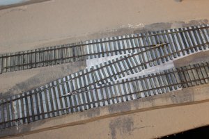

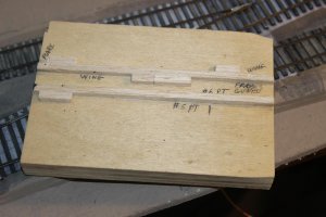

I handlay code 55 and 70 in HO, and have done code 100, 83 in HO and code 55 in N scale in the past. I have used a half dozen methods and all work, don't be afraid to try a couple different methods. Using Fasttracks jigs is all the rage lately. I have never used them. You can build in place, you can build on the bench. I have built components on the bench (frogs, guardrails, points) and assemble in place. Currently I glue a paper template to the roadbed, cut the slot/hole for the mechanism, glue the ties to the template, stain the ties and then lay the rails on the ties. I use a 1' vertical belt sander to "file" points and frogs. You can download paper templates from FastTracks. I use reduced photocopies of prototype switch plans. I found a MofW rule book from the 1920's for my prototype and it had switch diagrams down to a #3. Here are pix of a handlaid crossover under construction (note the paper template) and the jig I use to cut my switch parts to size.
