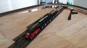

Here's my layout so far...
Look like you put a lot of planning into this. Looks great. Get the trains running and the scenery going. Send more pictures.

Here are some pictures of my new yard area...

Looks good! Might I suggest though that when uploading to Youtube you ignore any image stabilization 'help' it tries to apply to your video. It will help if the camera is not supposed to be moving, but when panning around the scene it causes everything to warp and distort. :)

Thanks for the suggestion! I'm going to do a new video and use my "real camera" on a tripod so I can concentrate on driving the trains. I'm going to, for lack of a better word, mirror what I have on the right side of the yard so I'll have the same thing branching to the left as I do on the right.

I'm very happy with the switching action. The only one I'm having a bit of trouble with is the one I used on my old layout (the same plan) I did 28 years ago....it's the double slip-switch (you can see it in the photo just above where the switch control panel is. It works most of the time but I always check it and if it's not all the way into position, I just nudge it since that's where I stand most of the time when trains transit that area of switches and the yard.
