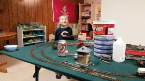

I did some model railroading back sometime ago, and after 6 moves and 3 kids, I am now to the stage where I want to get back into it. Plus, when my 4 year old son loves trains and asks can we have a train set, I could not get to the storage shed fast enough to get my stuff back out. So I got everything out and hooked up a small oval on a sheet of plywood in the basement, it took some convincing, but I got it to work. I didn't clean anything, just straight out of the shed and went. Well, as you can imagine it was not as smooth as it once was. I did a search on here to see what I could do to get things to run smoother, but could not see anything. So here is what I know I have...
I have hundreds of feet of atlas track, I assume its brass because of the color, I had this given to me 15 years ago from a family. I bet most of it was bought in the 60's. I have all atlas switches, some are still in the packaging. What is the best way to clean the rails? Years ago, I had a track eraser, is that the route I should go again? My son and I, hopefully with help from my daughters are going to build a 4x8 layout. I have been looking at layouts, trying to find something with that we can run descent size trains on the mainline, but also have some switching opportunities. Because whats more fun the switching cars and delivering their load...nothing according to my son. So if anyone has a trackplan that might work and is willing to share, please do. I am going to upgrade to DCC becuase I am not very good with the wiring of blocks, and at this time, we will be running just two trains and my son loves the sounds, who am I kidding...I do too! I am not worried about laying the track because I have done it in the past, just looking for advice and tips to getting the old track clean and reliable so we can have some fun.

Well, we got a small oval going with a few sidings. I have used some alcohol to get the trains running better, but not great. However at least they are running and my son is having a great time. I have been thinking about my future layout and I think I am going to go for a dogbone type. That way we can get in the middle, if I get someone some dimensions, we someone be willing to help me with track plans? I have downloaded a few free software programs, but I have not had time to figure them out. Thanks for the help so far.

Thanks for the help guys. I have gotten the trains to run smooth with some alcohol..for the track and me:o I have been thinking about my layout plans and think I am going to go more towards a dogbone type layout. I am thinking with my son, it will allow for more hands on operation for him. So I am looking for plans, if anyone has any. I searched for a little bit this morning, but could not find any. I have about 10' long to work with, and I would like a loop at both ends for the trains to come back. After running trains for 2 hours this afternoon, some sort of yard is necessary. As you can see, he is a happy boy. Thanks again.
