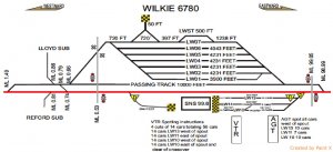

[FONT=&quot]I plan on starting with a yard and building off of that. Working for CP, I'd like to use one of the smaller yards we service. My questions for helping get this yard started are what type of switches (#5, #6 etc.) would be best for this application. I'm looking at Peco and Micro Engineering. Specifically at the lead switches (or ladder as I was informed) for the yard tracks. Second bit of advice I'm looking for is I've been told homasote is good product, but not available where I live. Looking for alternatives, and success stories.

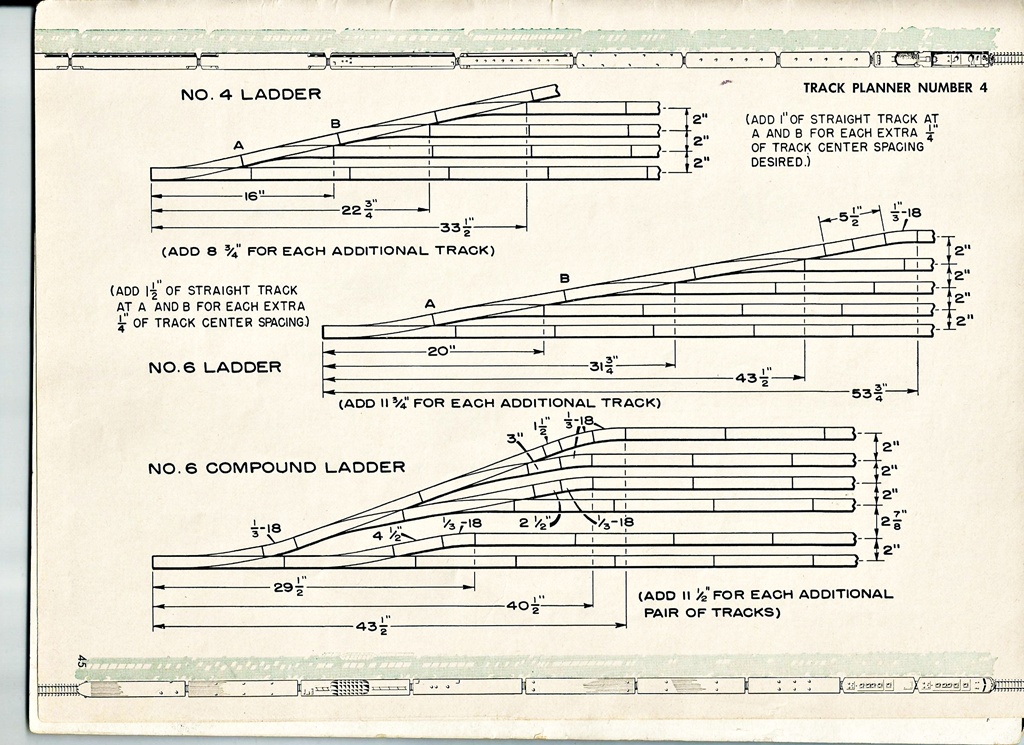

You did not state how large in square footage your pike will be. IF it is 32 square feet, i.e. 4 x 8, then I would suggest running a # 4 ladder. It is the best use of the space. If you need it .... here is your track planning guide from Atlas ....
I know, ancient history, but I am an old timer, and I am sharing with you the things you need to know ... print this .jpg out and keep it for reference.
Enjoy!

Appreciate the input. #6 seems to be the common denominator. I'm hung up on either Peco or Micro Engineering for quality of turnout that is more derail resistant. Also just to note for the record, this schematic is from work and I realize that in HO size it would be ridiculously large!
I think I may have been thru that yard, love the way the switches are laid out!
