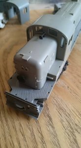

Now, the last RS3 that I bought, the tank doesn't want to stay
attached...

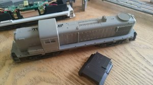

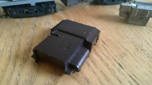

....which made me think, maybe I could or should change
it somehow, make it a fullsize fueltank and move the airtanks...

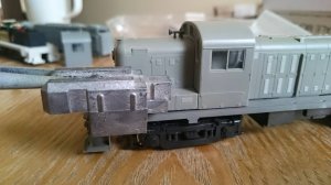

....from where they used to be and up to the top of the long hood...

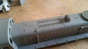

....should leave a bit to work on, shouldn't it, if you remove
some on top of the weight, right?

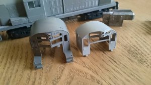

....then it's of course which cab to use, Alco Century or the
EMD SD24?
