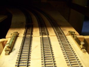

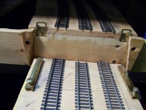

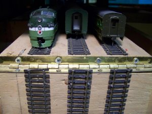

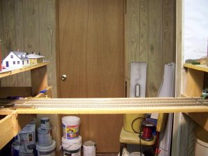

Here's what I did for a drop down section of my hidden staging area. It isn't along a wall though. It could give you an idea for track alignment. I put this up well over 25 years ago as a temporary fix but being that it worked, and is still working, why change it.
In the second picture you can see a couple of triangular scraps of wood that I screwed to the facia. These align the tracks up with no problem as they are slightly angled towards the top. The slide bolts lock the bridge in place when it is up. The piano hinge on the other side automatically keeps the tracks in alignment. This drop down section allows for continuous running for me if desired, but I mainly use these tracks for hidden staging for inbound and outbound trains for my point to point operation.
View attachment 53376View attachment 53377
View attachment 53378View attachment 53379
