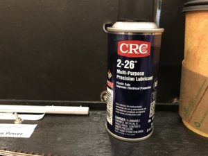

Been using this stuff to clean wheels and track,works pretty good.Puts like a protective layer on the wheels and improves conductivity.Quite a few of us use it in the club and noticed a reduction in the wheels on the engine getting that black film. You can get it at Home Depot and other box stores.

It isn't conductive, however it is used to keep electrical connections clean. It keeps water away and doesn't attract dirt. I have used it on pickup trucks and other conductive areas on my layout. Put it on and wipe off as much as you can. In other words use very sparingly. It wont cake up and arch like other grease. I have had no problems with using it.
