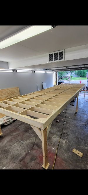

Longtime N Scaler taking the deep plunge into Z scale.
This layout will be an island walkaround setup with 3 separate loops for continuous running with no turnouts or towns . Nothing but scenery.
This way I can run Modern or 1950s.
I have the benchwork done and ready for plywood. 8" on center girders with double bridging.
I'm using the reliable cookie cutter method for the sub roadbed.
Follow along as I go.
Here's where I'm at today....
251.5 KB
I forgot to say the dimensions.
It's 17.5 ft. X 5.25 ft.
Should be a high ratio of scenery to track.
Sounds like a fun project. What prompted the change in scale, if you don't mind my asking?
I’ve always thought about doing this with Z or N, great scenery to train ratio!
I’ll be watching!
With those dimensions you will be able to fit a lot of Z scale action and scenery into this!
I too will be watching for updates!
I would recommend a single trailing-point switch and siding on each line, so you can back a train in and shut it off to run something else without handling the trains.
