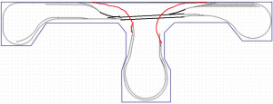

Getting close to having my layout finalized.. Looking for recommendations how to isolate my reversing sections. Below Ive identified where I initially located GAPS, then I added the crossover in the peninsula and the re-entrance in the left side crossover. Uncertain where additional gaps are necessary. Any advice where to specifically locate so all bases are covered?
Background: HO Scale/DCC/Peco Electrofrog w/PL10&13 switches everywhere but 3 insulfrogs curved turnouts, 2 on left, one on right/ Usually one train in use but occasionally 2, the second operator is 9yrs old/ Modern Diesel locos
To put into perspective it is 14' between turnouts on back mainline and 32' end to end bench work
Let me know if any other info is needed.. Any feedback greatly appreciated, thanks in advance!!
For starters there need to be a whole lot of insulated joiners or gaps just for the electrofrog turnouts. I've marked those with the red dots. If you also add feeders to each of the spurs there need to be more insulated joiners or gaps. I've marked those with the pale blue dots.

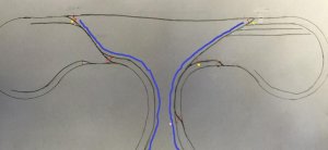

As for the reversing issues, what you proposed would probably work but it would be a bit strange. I always try to make the largest, longest run possible with no gaps. In this case that would be the entire outside loop. The way the back track drops into the front loop is a bit odd and there are many ways that it could be wired. I think the simplest is to make that entire swoop into the reversing section (the dark blue line), with the additional (in addition to those needed for the electrofrog) gaps marked in yellow. This way only one auto reverser is needed BUT only 1 train could be in that entire section at a time. So it might be better to break that again at the crossover to the center right. An additional insulated joiner/gap would be required (pink dot) and an additional auto reverser.
As I said this is just one possible way to do it.

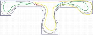

You were wanting to make either side a loop, as in the green in the picture below.
That would work if you moved the gaps on the very upper right (near the end of the yard ladder) to the other side of the turnout.

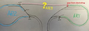

Even then you would run into the same issues that we just discussed on another thread where the layout is wired as a double track main with a loop at either side. Also there is that pink track. That combined with the red section actually forms another larger reversing loop shown in yellow. The more tricky part is that larger reversing loop contains portions of both of the other reversing loops. I'm thinking that if you wire the pink as a main track, it will further complicate the case as discussed in the other thread, or that you would need a third reverser on that pink track. A third reverser is also tricky as that would be a reverser off of two reverser sections.
As I said on the other thread and implied here, when using auto reversers I attempt to let them be in a relaxed state most of the time. Only seldom would they need to activate. The two loops on the end of a double main line has them constantly changing.
(And yes I know that "relaxed" is only a metaphor with the 100% electronic ones).

As far as my GAPS/isolation, you mention the need for the gaps on the upper right turnout on the opposite side... I was just evaluating and realize it is naturally gaped from the 2 electrofrogs meeting there... So for my simple mind, If I were to stick with 2 loops on the ends what additional isolation is required for the original diagram? The third reversing unit lost me Thanks Again
None, I don't think. You can wire the pink line directly as a main and see what happens. While an AR looks good in theory, I don't like the idea of it passing into another AR section.
