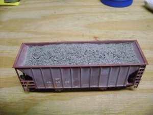

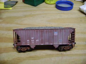

I plan on weathering some Walthers ore cars that are colored brown. To fade the cars before the main weathering, I plan on using acrylic white as a base with a tint of Grimy Black or Rail Brown to "cut" the white color. I will mix the paint 10% White, 2% Grimy Black and the balance 70% alcohol. I will apply using an air brush in light coats.

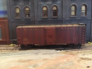

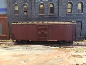

For my fading I use some watered down (acrylic) light brown (or khaki) with a little gray added for the first coats with the airbrush. Not sure of the % however mixed it the way some people cook (looks good to me). My tip is wide so I use several light coats. I used only water.
That gives the dust and fade appearance. I usually follow with a second step of watered down black with a little gray added to darken along the bottom of the cars and ends.

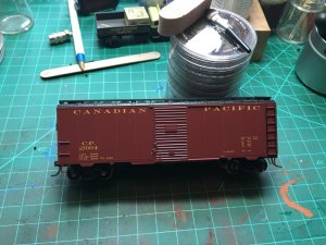

Yesterday, I tried a mix of Camo Gray and Rail Brown which I brushed on a sample box car. The color looks almost right, but need to use an air brush to be certain and more light layers of paint I used Camo Gray since white maybe too bright and need a lot of toning down.
Please still offer you ideas and methods since weathering has so many different approaches and ideas.
