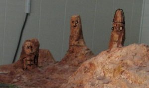

My first glance at the pillars gave the impression of:
The right one reminded me of a conquistador
