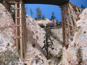

Some of us are into scratch and kit building. Some of us like to build our bridges or water towers. Some of us forget that maybe we should have gone to the LHS or epay and bought these:
A wooden trestle is one thing, but a wooden trestle that has these used is something else! Trust me a photo can tell, as well as most guests to your layout, that you have gone that little extra step that separates adequate from just okay.

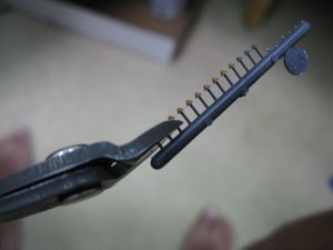

This product comes in HO scale sizes from my LHS. I like the largest size because they 'standout' more. Smaller is okay and may actually be more in scale. The fact that these nuts and bolts are there is the important thing. I like to use bolts with washers because again they're larger than a simple bolt head in the wood. These bolts DO NOT go through the whole wooden trestle part and come out the other side. They are like 'stick ons' they only go on one side of the structure. I cut the bolts off the sprue like this:

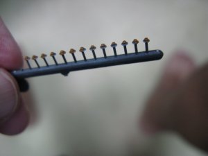

I put them in a saucer so I can pick them up easily. Notice I have painted the tops with rust colored paint to show some aging. This is up to you whether your structure and bolts are old or new. Notice I cut these bolts off and left some 'tail' attached. This is because in the next step you will see how we make insertion holes for the bolts. There are a few ways to make the insertion holes. First is this way:

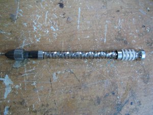

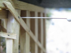

Here you see the pin method. This is okay until you start pushing your structure over! Put a finger on the other side to hold the structure steady. Another way, and my favorite is using this pin vise drill.
The bit barely shows but this device will do your hole in an easy safe manner. Notice also that I've marked the hole positions with ink. I did this not for this job, but for simulating 'bolts' when viewed from across the room. Reasonable facsimile! Some leave their structure with no markings or bolts. I'm hoping to get you folks to take the next step. The last way to attach your bolts is to cut them off the sprue and glue them on. I seldom use this method because it is messy and glue just seems to get everywhere.

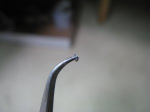

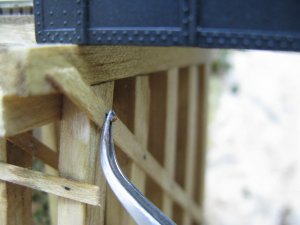

Next up you need a tweeser. I like this curved one:
I like this rounded one because it picks up bolts, even if the stem is cut to short! The curve also allows you to eliminate contortions with your hands and wrist. Here is how the bolt goes in your pre-drilled hole:

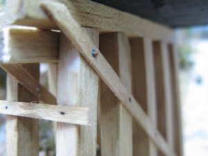

When I get to this point I put my finger of my other hand up and press the bolt into the hole. If you've drilled the hole deep enough and left the stem long enough then I don't use glue. If you left the stem really short like the previous photo then you should dip the stem in some white glue and then insert. This is what we are trying to do:
So there you have it. Go the extra step. These bolts are like $4 per package and you get a lot so give it a try. Jim :o

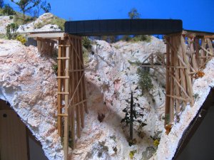

Here is a before and after shot of the bolts or no bolts.
me!
Hopefully you can tell the differences and see the point of making just a bit more effort. Jim :)
