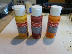

Having gotten fed up paying on average $5.00 for a little bottle of Testors acrylic paint I decided to check the Internet for an alternative. Turns out a lot of the model car guys are just using the cheap bottles of acrylic paint from Michaels and Walmart and thinning it with windshield washer fluid. If a gloss finish is required they spray floor polish!

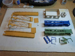

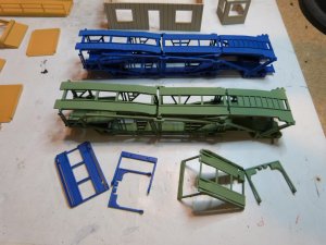

I painted all the parts for the Distribution Facility using craft smart acrylic paint from Michaels and couldn't be happier with the results. Still need to detail, weather and decal everything, then give it a coat of clear. As part of the decals I ordered some conspicuity tape decals for the trailers, so will see how they turn out.

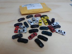

I also ordered some cheap cars off of ebay to fill one of the trailers. If the quality is half decent I will order more to fill the parking lot of the Distribution Facility.
Received my package of cheap cars from ebay today. All in all they aren't too bad - maybe a little under scale but they will do fine for the Distribution Facility and auto racks. I think I will order some more to fill up the parking lot.

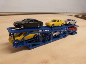

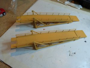

I finished painting the auto carriers and unloading ramps for the Distribution Facility. The last touch were the conspicuity tape decals.
I also laid out the facility on the layout. I tried to make the flow somewhat realistic, based on the limited space I have. The under scale cars make it appear larger than it is.
I have another cab on order for the blue carrier, and will need to order more cars to fill in the lot and one of the carriers.
The next step is to get some patching compound and start making pavement. I also need to think about what I am going to do for fencing. The fencing included in the kit won't be enough for the whole facility.
Where did you get the loading ramps for the Autoracks? I need to get 3 or 4 of those for my own layout?
