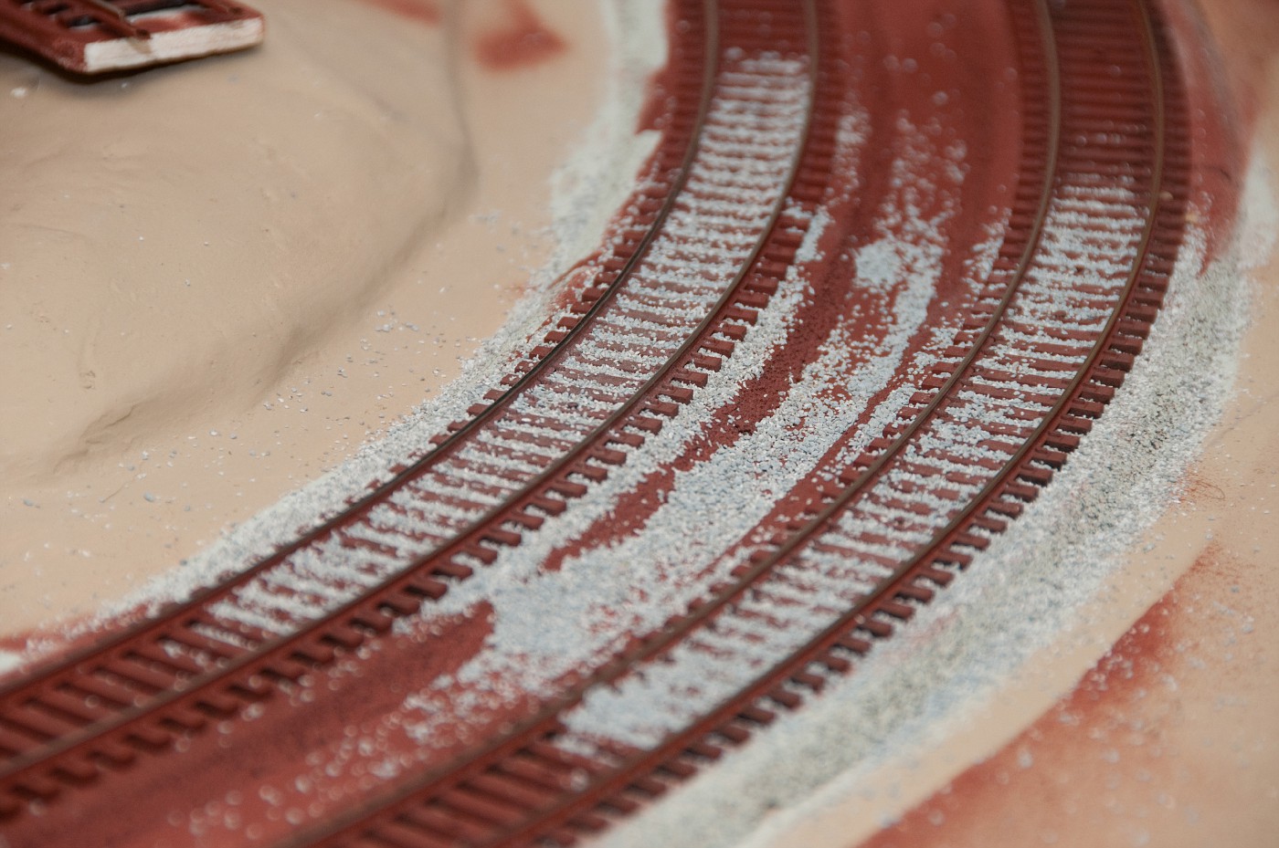

so, its ballasting time. i'm set on using WS crushed nuts (available and not to expencive) but the size still bothers me. i bought a baggy of medium grey and shaker of fine grey mix (after reading some of you do use it). tried both but i just can't make up my mind. medium seems just a ted big, fine seems way to small, really much more suitable for N. (below. will vaccum and paint ties into proper color beforehand)
Fine
Medium
what are your thoughts. anyone uses medium at all?

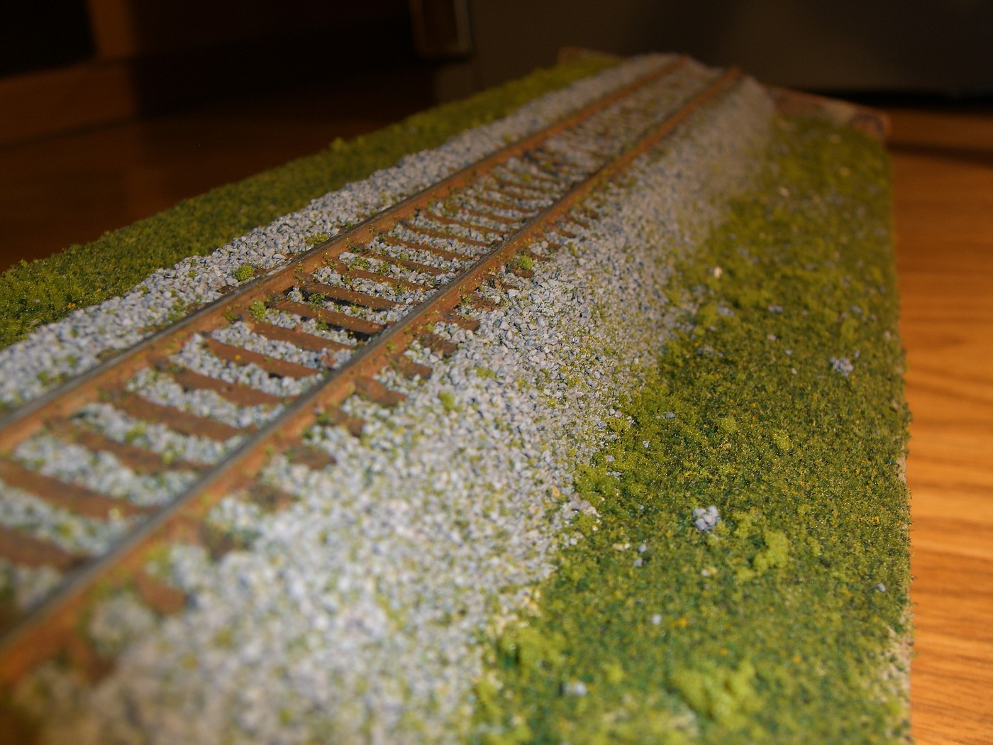

for my HO layout, I used N-scale ballast
attachment.php
is this really N scale? from the pic it seems even bigger then medium...
i think i will try and mix the 2 sizes......
I think that looks good.

as far as size i narrowed it down to 30% medium, 70% fine mix (loked good on the diorama) although it seems not critical.on pictures i looked through there are actual roads ballasted with huge pieces . looks strange but well, apparently works.
