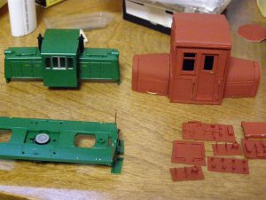

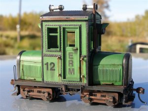

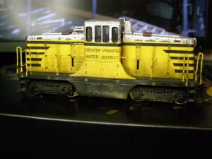

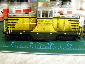

Here it is converted into an 0n30 Loco. The 44 Tonner has been fitted with new handrails that are much closer to scale. I used the original stanchions and drilled them out to fit the wire. Here's a before and after picture. The second pic shows the original handrails.
View attachment 39180 View attachment 39181
View attachment 39184 View attachment 39183
