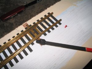

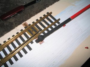

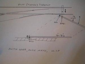

I am working on the very same issue. Made some sketches this morning for a home made device. I will be putting it together this weekend and post the photo monday.
This will not cost you anything, work on plywood only, and be something you can replace later when you decide to upgrade.

Here is a crazy idea that you may want to experiment with, it you are that type of person. Just a simple lever and a couple nails. If you want to get more artistic, you can come up with something that better suits your taste. I got this idea looking at some switch throws on the BNSF.
This is going on a suspended layout, and the long lever is for ease of operation; as the plywood section will be located about 6 1/2 feet above the floor.
I will put some description and more photos on my alternative materials thread.
