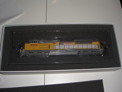

The Unit come in the standart size Genesis box, but is dark blue, and has many manuals inside, one is a very very very detailled exploded diagram of about 18 pages of exploded view of the details part, mechanism, electronic, and lubing detail, in all possible Athearn variation for the m-2 or ace. I read the manual and I can confirm you that athearn has made the mold for a high mounted headlight with a whisper cab ( with the black gasket ).
Unboxing

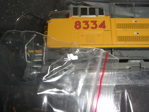

Unit is packaged in a RTR like fashion, two piece of molded plastic hold it from top and bottom and are slided in a plastic rectangle. Handrail are protected with foarm and the pressure point of the package are covered with a soft plastic sheet to prevent damage to the paint.
The Cab camera is supplied as a separate parts, and must be glued, it is located in a slot over the locomotive. many people complained about the part missing, but finaly found it under the outer foam insert ( the slot goes all thru the foam).

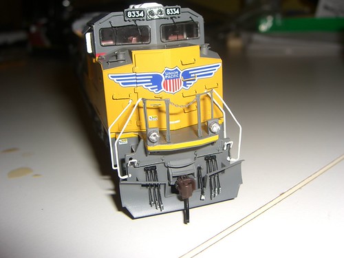

The details on the unit are very precise, and for exemple, the wipers are of an aftermarket detail part grade with precise molding and no bur. The side handrail are straight, but the front and rear are in a funny position due to the way they where molded. To be replaced in a near future

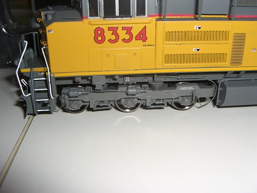

Truck detail level is really high and even the emd logo was molded on. Decals warning are numerous and for the most part can be read with a magnifier.
Most of the frame details are glued on. The only mistake on my unit is the slighly angled jack pad

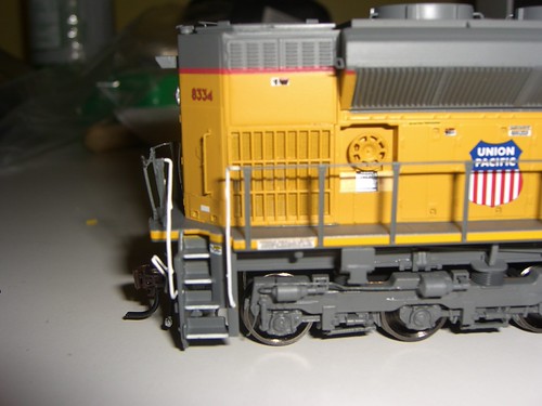

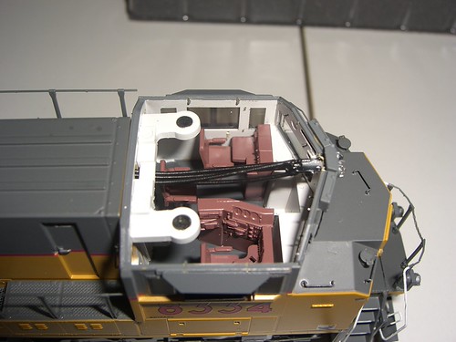

Cab detail is extremely precise, side window are "frosted-glazed" to simulate window tint. Control stand is detailled with all the handle and button, even the coffee holder is present. Not really essential is you ask me, but the roof make it easy to change the headlight. A really stupid thing would be to glue it, since the only way the cab interior can be removed is pulling it out from the top. glue it and no acces to the headlight anymore. When properly closed, the top do not look like openable.
See-thru grills are present on this unit and the chicago blower inside is screwed on the frame. the blower is positioned too much to the rear(vs proto), but has been done to allow the truck tower to come out. Works for me. Unfortunatly the camera isnt able to see thru them:(. grills are etched metal and not painted on transparent plastic. Exhaust is also see-thru, as well as a little acces trap on front of it.
