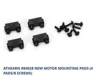

If you do try to remove the motor, be aware the motor mounts will probably crumble to powder if you disturb them. I'd pick up a set and replace them, even if the mounts don't fall apart. They're at least 50 years old by now.

Bathroom sealant or caulk as you guys know it would be a better solution if @catnippertom can't use the original motor mounts again, you know what Murphy's Law is like.

After watching your I believe you have a loose connection somewhere. . When the unit looses power the head light dims. In my opinion when the unit is in the turns the motor is shifting enough to break the to the frame. I would change out the motor mounts to the type that screw in on the bottom. I have had a similar problem and it worked for me. Now whenever I get a Athearn the first thing I do is change out the mounts. Good luck
