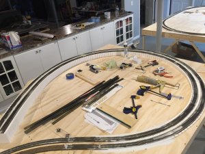

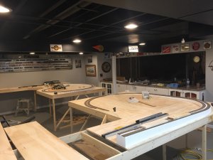

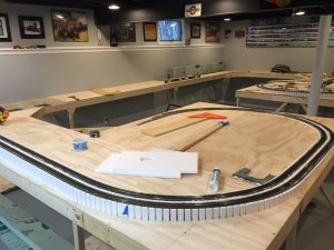

Had to use some heavy plywood on the ends for weight on the table. I am going to use some woodland scenics risers, foam and maybe some traditional risers. I guess a little of everything. May have to drill a little more than I wanted but for now this is the best plan

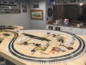

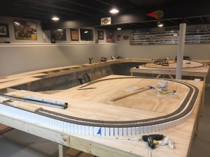

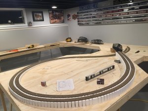

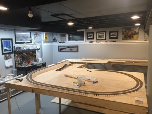

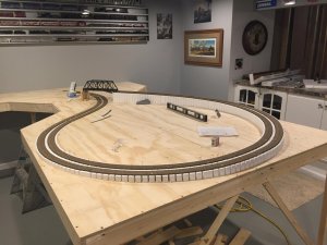

Let me tell you I was a little concerned installing some Woodland Scenics foam risers. After installing these I am really impressed. They say it is a 2% rise but I could only get about 1.85% rise from my measuring gauge which I am very pleased with. I think the best thing I did was after I installed them I took a light cheese grader tool and made sure there was no high spots. Then I used Woodlands Foam tack glue to the cork roadbed down. I choose cork only because I am used to using it and I would not use the Foam roadbed Woodland makes. So this is the start. I decided I was going to do the big radius on both ends of the layout like I said in my previous post and that still seems like a good idea. Now I have a start and I can't wait to start laying track.One problem with the track though. I opened the box to check it out and realized my hobby shop gave me code 100 instead of code 83. So they reordered the correct track. Oh well I have a lot of other things to get done first. The outside turn is 34 degrees and the inside is 32 degrees. I can live with that , It should run anything I want to put on the track. Here are a few pictures. I will keep posting as I go.

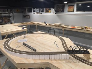

Yes Chet I am satisfied with it. no more than 2% in a 16' run. I think it will get me to the upper level just fine. My old layout was around 2.75% ( very close to 3% in some areas with tighter radius) and made it impossible to run bigger equipment. These are broad curves , slower rise and should be able to climb just fine.
Anyone see anything that would hinder that please let me know. Always open for suggestions
The grade shouldn't be a problem. The curves are broad and should look really good. With the broader curves there shouldn't be a tendency for cars at the front of a long train to want to tip to the inside of the curve. Just posted this video on the coffee shop. I went and super elevated my curves and at the top of the grade the first few car of the train (not in the video) were getting a little tipsy but did not derail. The curve at the top of this grade is about a 42 inch radius. https://www.youtube.com/watch?v=wFIIWvaTiIk
Also the broader curves don't look toy like and are easier to blend into scenery.

I spent a lot of time this weekend finishing some more benchwork and yes I started laying track. Like I said I wanted to get the radius done first .Everything I am doing is new to me. New PECO track ( Which is the BEST I have ever worked with), glued down Cork roadbed and glued down track. No nails at all ( So Far) I have been very picky laying it out. I am using some radius tools to make sure it is as perfect as possible.I can't wait to test run, but that will be a while. It will be like the Trans Continental Railroad and I can't wait till they meet.. I laid down about 23 sections of flex track and I have a long way to go. Already have a ton of design changes going through my mind. Dang this is going to cost me!! But that is what we do this for.
Model Railroader usually advises a bead of caulking along the centerline, then spread with a small trowel/scraper to the width of the track, tacking the track down onto it with push pins till set.
