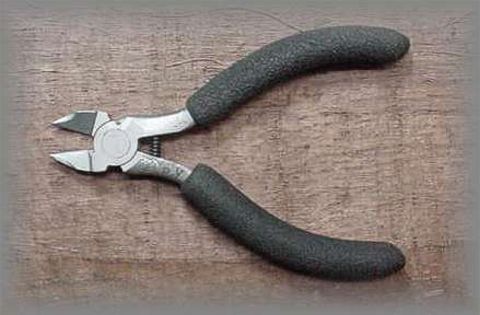

Ken has it right. You cut off the plug and strip the two wires and insert them to the two terminals at the top of a terminal block, like the one Ken has in his post. You can now run as many wires as you need to different power terminal tracks. This is something you'll have to do eventually anyway so might as well do it now.
Thanks for the tip. I'm not sure I want to start cutting wire though, plus I can't see how that can connect to the controller.
