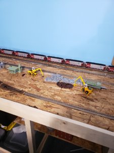

Yikes !! That's quite a lot of bits and bytes over flat bench work !!
That’s really coming along, I like how you framed it in!
I’ve never used OSB but I do know it’s superior to the older version, chip board.
I’m using plywood myself but I noticed one of the sheets resists track nails very well.
Rick - the last plywood sheet I bought likes to bend track nails, also. So I keep the drill handy for pilot holes. Next time, I'll have to specify "track nail friendly" grade plywood
Thanks for the kind words yes I have a 3D printer I will look at the web sites thanks.
My last 2 layouts I used OSB board for the sheeting, and had no issues. As stated the cost savings is significant. I sealed it with a cheap latex paint.
The only thing I dislike about OSB is the glue smell. It just never went away!
A lot depends on where you're located and how big the layout is. I live in Seattle, and so humidity is always a factor. After time, OSB can swell and crack, especially in damp locations. Painting helps with that though.
I'm old school, so I prefer plywood. I'd use 3/4" structural grade if I was building a layout today. But if I was starting my layout over, I'd only need 3 or 4 sheets. Being in the PNW has it's advantages, I can get a 4 x 8 sheet for under $40. The thick OSB is about 20, so in small quantities, the price difference isn't huge. For a large layout like this one? That's a different matter, far more financial impact.
