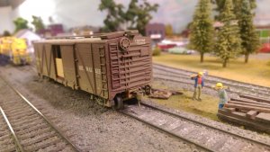

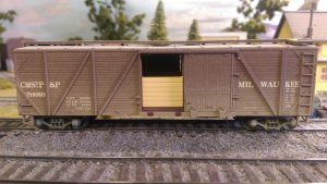

Here you go David. Picked up a couple, with different numbers.
Chet, that Milwaukee box looks remarkably good. The weathering makes it look much better than the stock Walthers catalog shots!

Good looking car, great job Chet!
Thanks for the complements. Took about 15 seconds with an airbrush and a shot of clear flat to seal the paint. I'm lazy.

Chet, I really have to take my hat off to you with your weathering. It sounds like you have a really simple process that yeilds awesome results!

Nice job on the box car weathering. What color did you air brush on the cars?

Sorry I didn't get back to you Greg. The color I used was Floquil "Mud". I usually give the cars a licht dusting from the bottom. This way the trucks get taken care of at the same time. Now that Floquil is history, I havseen a mud color, but I guess any tan or buff color would work, but I would thin it down fairly good. The floquil mud was no where as opaque as normal Floquil paints. A little experimenting should get you good results. I always over sprayed with a clear flat to seal the paint.
