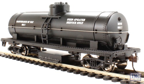

The tank can hold quite a bit of track cleaner juice, i.e. alcohol or paint thinner.

I just purchased a CMX tank car cleaner, all brass, last year and I have run it around my track system exactly once. Then, spring came and I went outdoors. I'm just thinking of going in and taking another stab at cleaning the rails because nothing has moved in my train room, in the garage, in six months. I will wipe by hand first to clear most of the dust, and know for a fact that there's dust. I can see it. Then I'll run the CMX with lacquer thinner (which the latest science says is not the best choice, but that's what CMX recommends, so....).
